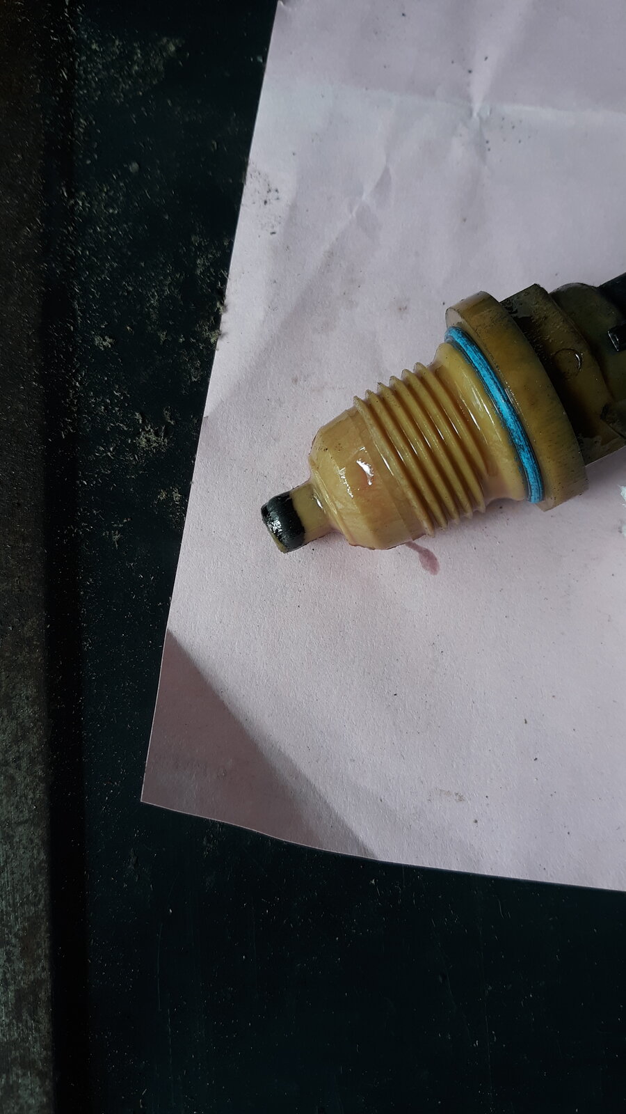

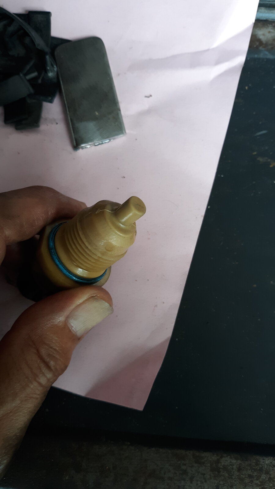

What's presently happening literally "just" started last weekend. And, happens with OD off as well as on. I'm going to remove, look at and clean speed sensor on rear of trans.
Any other suggestions on what else could be causing and what to check/do are greatly appreciated.
Yeehaw!!! Thankfully the "dirty" speed sensor in OD case was culprit. 2,000 rpms rock steady for 50 miles.
