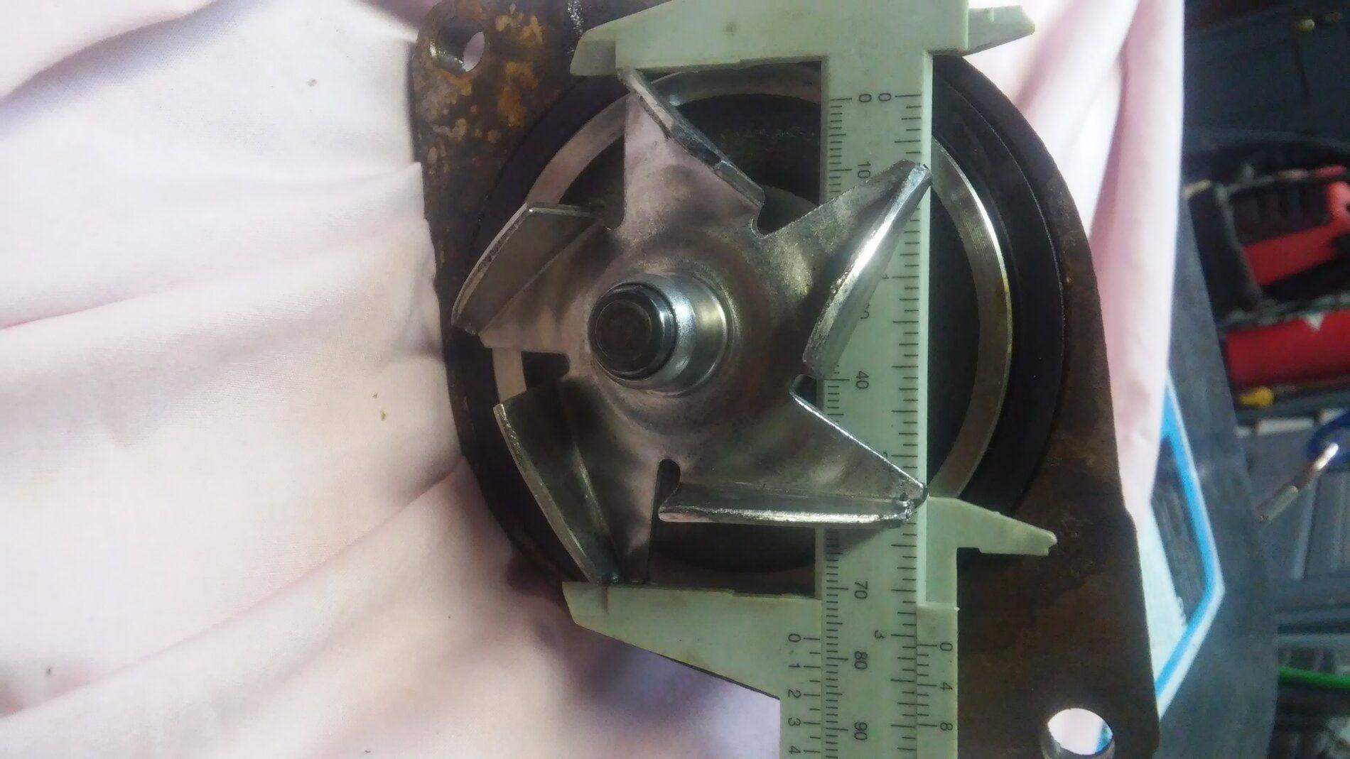

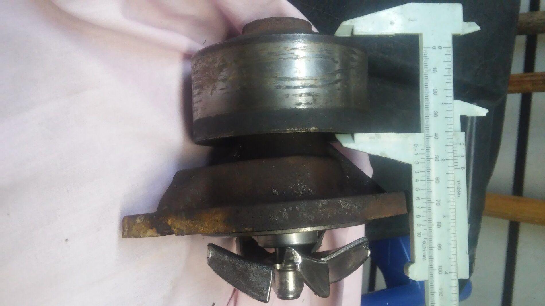

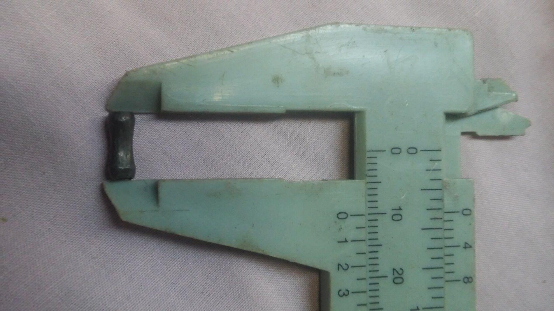

UPDATE-FINAL RESOLUTION
NO joy - no joy. Constant coolant leak directly above my "target" for attaching the belt
, the tensioner pulley, couldn't block it nor divert it. Arrrgh. Still no one willing to come get me out to the street, so wrapped up our stuff, and I drove it with emergency brake @ 80% and horsed it 'round corners, foot by foot, to the street, whilst #3 son's truck was traffic blocker. NOTE: Our Diesel must use the Pwr Steering Pmp for "hydrostatic" assist for steering & brakes, as there is no 'engine vacuum'. Parked it against the far curb & had a Pastrami sandwich on the tailgate waiting for the flatbed. We still had a good time & a few laughs. Rather be fishing, but hey.... Truck delivered Sat. to my diesel repair shop 30 miles South & picked it up today, Tuesday the 9th.
The water pump bearing was severely worn, its shaft drooped & eventually breached the water seal, dowsing the belt in slippery coolant, etc. NOTE: Granted, driving a Focus or Prius or Kia Soul, I might have heard the bearing issue. Since I had previously purchased: upper & lower rad. hoses, tensioner pulley assy., water pump & 4 gal. Xerex GO-5 coolant, the truck came complete with repair parts for shop opening Monday following July 4th wkend. NOTE: Shop owner was totally OK with my parts supply; said it actually helped him get my "small" job out of the way so the money jobs could move in.
All the above were installed & spousal unit's confidence level rose from 2 to 6; mine is back to 10 where it belongs, eh. For those without carnal knowledge of our RAM water pump, I enclose pics of it & one of the roller bearing elements that fell onto my hand. Thanks everyone for your support & interest.
P.S. Mechanic Mike confirmed what I thought, that the Cummins Water Pump design & placement is the easiest to replace among our competitors. The V-8's are costly labor items.
