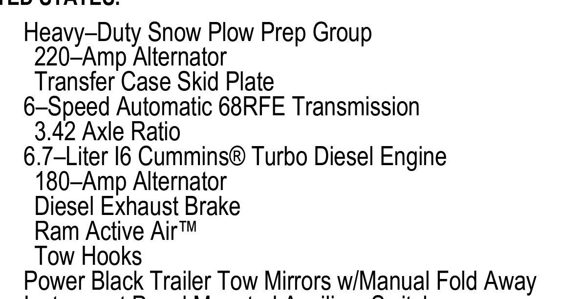

Look under the Cummins engine option over on the right side of the sticker. I’ll bet 3.42’s are listed there. If it’s a 2018 2500 w/Cummins, it IS geared with 3.42’s.......

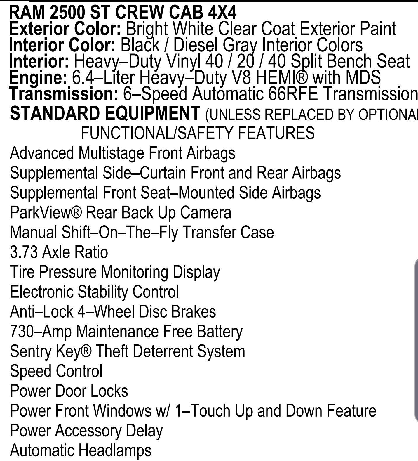

Forgot to ask OP if it was a 6.7 or a Hemi, my '18 2500 is a 6.4L gasser.

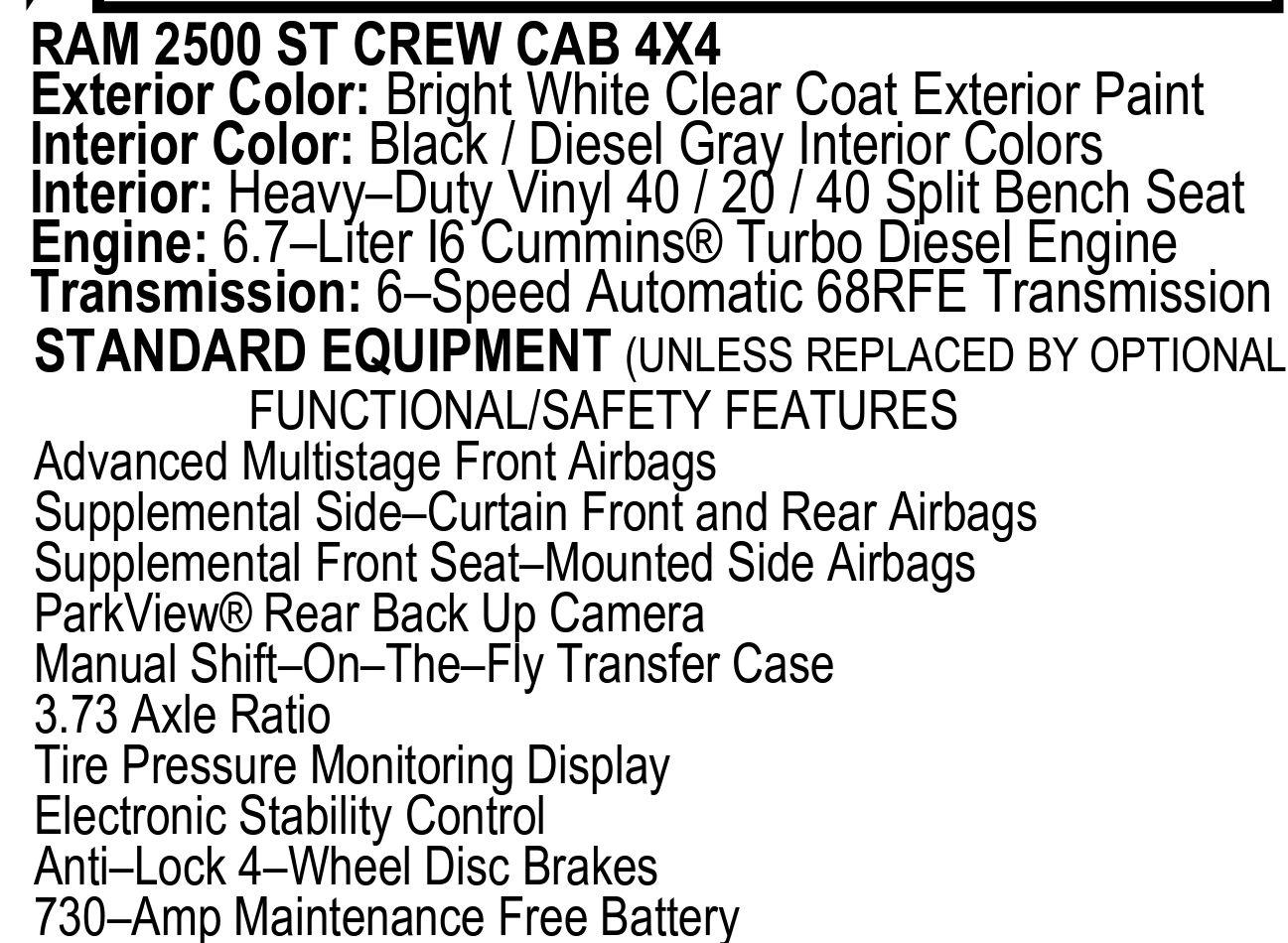

Looking at the 2018 window stickers I have saved, one was 6.7L, other is mine.
3.73 is showing as the standard equipment for a 2500 in general, once you add a Diesel look further down in the options and you will see that changes to a 3.42.

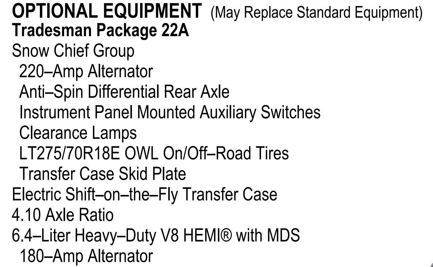

My 6.4l gasser was also standard with 3.73 and optioned out wit 4.10 LS rears.
