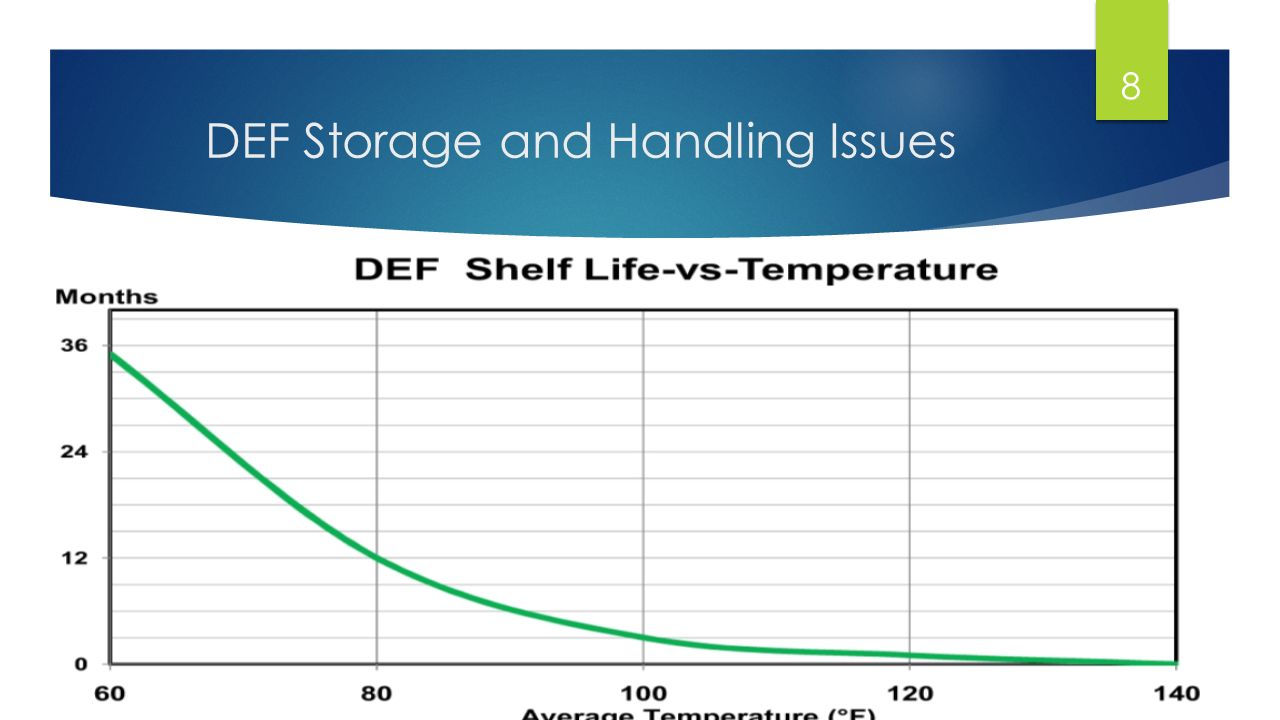

I haven't found one on my 2014 and no mention in OM as a maintenance item. Maybe a newer thing on equipment that is used in dirt/dusty environments. I've got 176K on the clock and just putting fluid in it. DEF pump was leaking and cause it to not give level reading but would pump. This cause a de-rate and needed to be replace. I looked and it was just a pump with float similar to a fuel pump/gauge setup. Just remember that DEF has a shorter life with heat. Run it til low level light and refill with fresh for amount of driving to avoid going bad.

Thank you for taking the time to check for me. I’m very familiar with the heat issues. Had a customer last that was storing the def in the convenient compartment in the front of an enclosed pump. Right in front of the radiator with a forward blowing fan. Took me a little bit to figure that one out. Had another that added water to the def system when they didn’t have enough def. Concentration level went down to 27% and shut the unit down. It’s fun stuff
I keep an emergency storage of 1 container of DEF in my wine cellar basement. I only keep it down there for 1 year before use.

If it is stored properly it can be years old no problem, if stored wrong one month can kill it.
