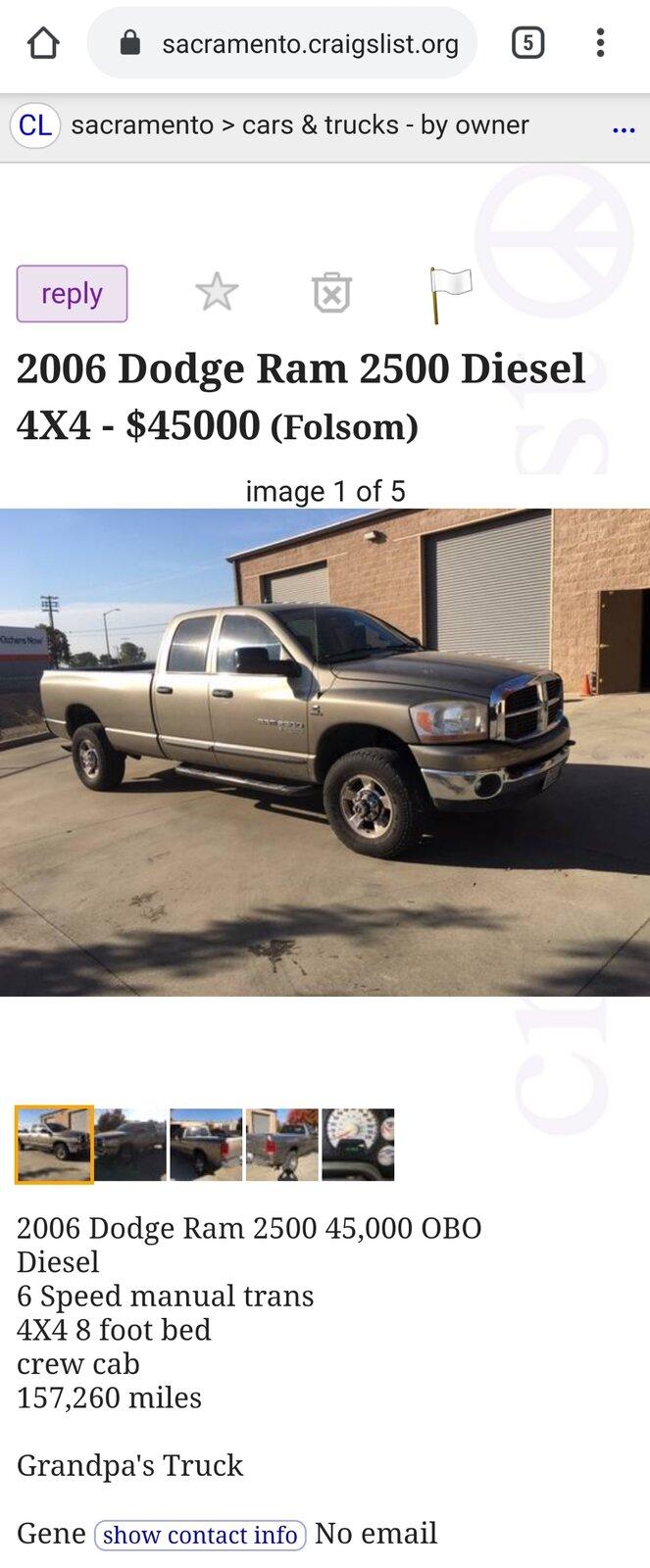

This came across my news feed today....:eek:
Will save some the click.
https://sacramento.craigslist.org/cto/d/folsom-2006-dodge-ram-2500-diesel-4x4/7014838756.html
