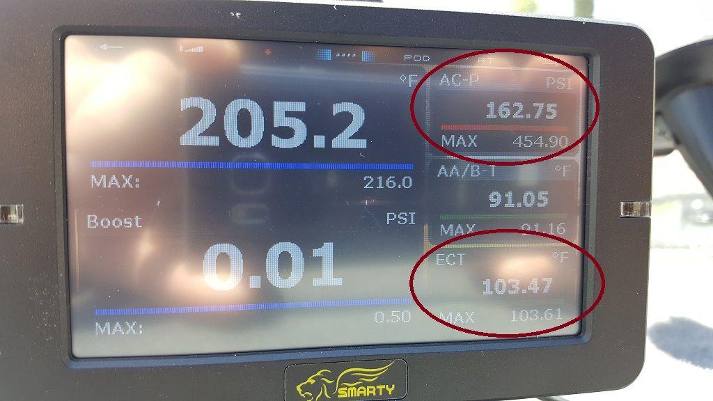

I stand corrected about extreme heat being a factor at all. If I idle the truck cold on 75 degree days like we have now I can still get 450 PSI on the high side. Further watching the fan % commanded to 99% at idle the fan is doing a lot of NOTHING for a LONG time. The only thing that matters is the fan isn't kicking in from around 250PSI to 450+ PSI. Specifically seeing less than 400 RPM on the fan.

So final answer is the electronically controlled fan does not lock up fast enough or at all from a cold start at idle speed. Outdoor temp has nothing to do with the eventuality that the system will 'run away' and vent from overheating the condenser. Blower speed doesn't matter because low speed won't buy enough time - again because the fan isn't locking up at all. The official fan clutch test is to short a wire and wait 15 min for the fan to kick in. It doesn't take 15 min to vent the system at 450+ Psig even on low speed.
Solution is high idle with blower on low till the fan kicks in.*
*Without gauges you can hear the fan kick in. Once it's locked in you are ok to use normal idle RPM and higher blower speeds. I don't use high blower speed when idling unless I am watching the guages. This is lower risk then the OEM vent the system at idle setup. If you have high idle it's best to leave it on anyway. Gauges would take the guess work out of this. My Smarty is set to alarm at 400 Psig for AC high side pressure.
Watching my Smarty Touch I see 99% commanded fan from AC pressure at idle cold start. Going from 250 to 450 Psig the ~500 fan RPM doesn't change at idle. Now if I take the same cold start and bring the engine speed up to 1200 RPM (high idle if you will, no I don't have high idle working on my 2003) the fan's 500 RPM will lock up before 400 Psig. Warm engine idle the fan kicks in from low RPM.
No, being in Phoenix is actually an advantage: the cool days (aka my winter your summer) when the fan can kick out and stay out leads to more cold starts with the fan kicked out. Hot days has the fan lock in before I shut it down and it's locked up in morning sickness the next cold start avoiding the problem. Yes, the AC system is cooled by Ram Air so if you get moving the fan doesn't have to kick in unless it's hot out with blower on high and that's still MPH dependent.
So there you have it: two problems collide to vent the AC system.

Time for an update. This past spring I was watching the AC high side just run away no matter what. The 400 Psig event in a drive through line after engine warm up was showing me that the fan clutch was taking forever to respond and get up to speed. Considering the fan clutch was at least 6 years old IMO it's due anyway. (It's a known 5 year fan clutch life on obsolete spring thermal fan clutches as they loose 200 RPM per year. Guess this is one way electronically controlled viscus clutches slowly die.)
So I replaced the fan clutch with a MOPAR unit from Geno's Garage. (Their advice was the fan should be on in about a block with the AC on. Yeah, it used to do that when I bought the truck.) I also replaced the fan shroud because the old one was hard and had some of the lower shroud retainer parts were missing having broken some unknown time in the past. The old shroud was so stiff it came out with a sawzall. The new one had enough flex to install without major surgery. The coolant recovery bottle was in the way as I recall.
