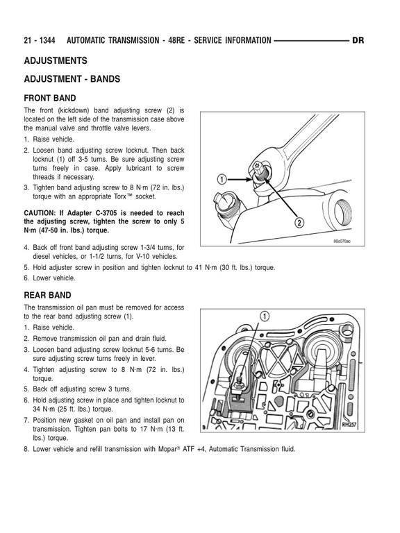

In my 2006 Dodge Diesel Automatic transmission has 42,000 miles pulling a enclose car trailer all its life. Does the transmission have a adjustment? I want to install a new filter. So far I have done nothing to the transmission. I change the engine oil and filter every 3,000 miles. I know I could go more but I plan on keeping this truck all my life that I have left.:-laf Its never been in salt, snow or left outside.
There is a front band adjustment and a rear band. Im at work so I dont have the specs right now. I would also install an upgraded governor pressure solenoid and sensor. Make sure you use atf+4 fluid and any parts store filter.

Will this help ?

My 2006 Dodge is in the shop having the transmission service and updated as you have told me. I have a friend that has a transmission shop and I explain what you fellows told me and he agreed and said no problem. Don't know what the cost is yet but will find out when he is done.???? I bought this truck new and I am 75 now so I will keep it until the end. It still looks new. So does mu 95 Dodge Diesel. It only has 62,000 miles on it.
