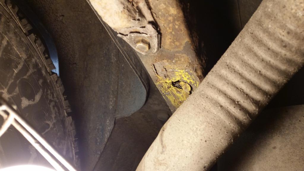

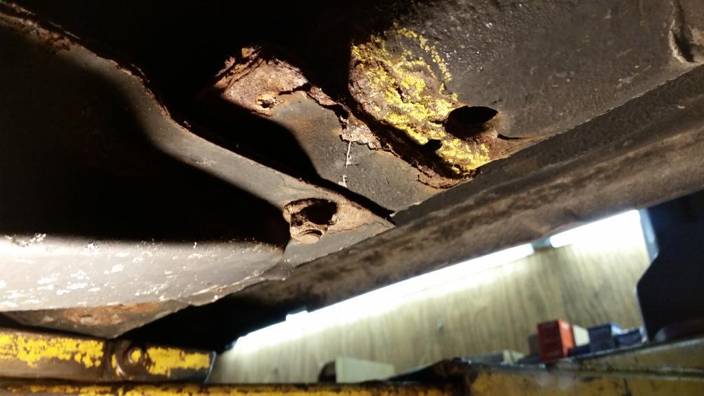

Saturday he calls me and told me to go pick up the old Jeep and see if I can fix it. He had taken it in for inspection and it failed. So I bring it home and put it on the lift to find the following.

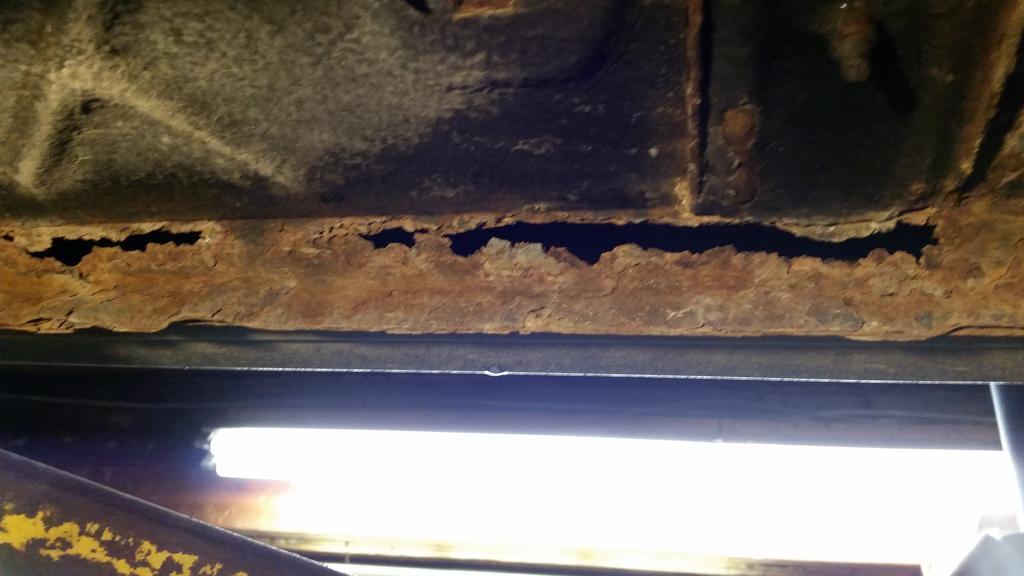

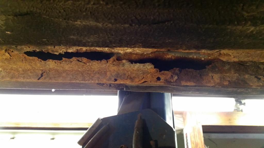

Drivers side inner rocker.
Passenger side "frame"

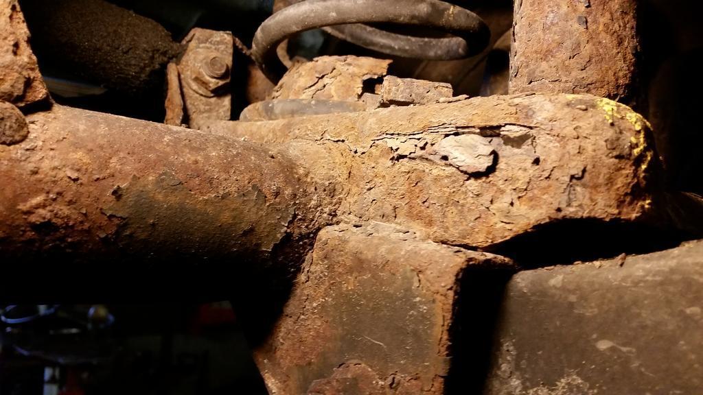

And finally the passenger side front axle spring bucket and shock mount.
Now the Jeep had 146K on it right now. It runs great, the AC works, has some wiring issues, but is otherwise pretty decent for a 16+ year old vehicle. It also needs a driver's door and outer rocker panel for inspection.

Sounds like it's more a sentiment thing than necessity. IF I were going to keep it, I would not go down the "fix rust" rabbit hole. Been there there/done that. It'a always much worse than you think and that looks pretty bad.
I'd either buy a same year rust free model and use your Dads for a parts rig when needed, or pick up a rust free unit and swap components.

I did some looking around on Craigslist tonight and I found a complete front axle assembly from a 2000 for $200 and rust free drivers door for $125. My buddy who has a body shop said that he would do the spots on the frame, the inner and outer rocker panel, and paint the door to match for $1200. That's just the minimum to get it to pass inspection if we don't find anything else in the process and providing the used parts don't need any work.

got started making Mopar frame repair sections. Looks like they've branched out a bit, but I see nothing for the XJ Cherokee which surprises me. I'd call them and see if they have anything in the works. I'd also hit the XJ forums. There were a couple of good ones a few years ago. These Jeeps have a fierce loyalty in the off road world. There has to be something out there. None of that looks too bad unless she folds in half or cant open the doors on the lift.

Given the XJ is a unibody vehicle you're looking at structural damage. I'd send it off to the scrapyard. You could buy a rust free XJ for about the same price of the repairs if you don't mind traveling a little to pick one up. I'm spoiled on the rust issue since I live in AZ but to me that XJ looks done (and I've owned a few of them).
