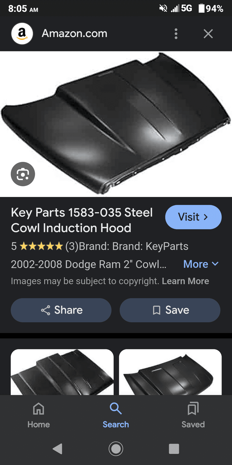

As a follow-up question these cowl hoods that I am seeing for sale used to be about $500 down seeing them six to $750 from key parts. Did any of these trucks actually come with those on it to where I might get lucky at a scrap yard? I know the SRT-10 and some others have hoods that have scoops and also somewhat of a cowl situation going on but it's not really what I'm looking for I don't want to jam more air into the hood I want to allow air from under the truck to slip over the top of the windshield and I also just think it looks a bit more robust it has a good look to it in my opinion. The only option I'm aware of is the key parts 2 in that sells it a number of different places but if there's something else I'd be glad to look at some options it's a good running truck I've probably spent around $20,000 trying to restore this baby and make it better make it into the truck that I want to keep forever it's about time that it looked like a truck that was well maintained and modestly upgraded. But I don't want to look like the SRT-10 or a race car with some kind of a ram air scoop on the front. I've also been looking at kits that you can buy I have a structural guy at work that I would trust to give me a hand with that but it seems like an awful lot and it also seems like something is just tacked on to the hood.

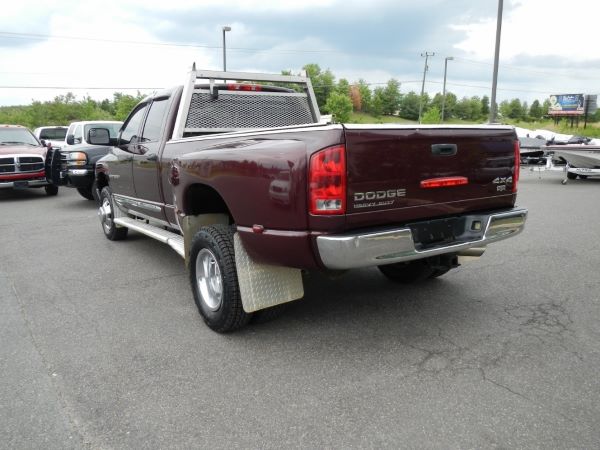

I don't know how your search is coming or what you have found, but back in 2014 when I bought my 2004 dually it had wheel-to-wheel running boards, but they were done in two separate pieces. One from the front wheel to the back of the cab, the other from the back of the cab to the front of the rear wheel arch. Like this:
When I transitioned it to SRW later that year the back sections of running boards stayed with the dually bed, which the salvage yard that I bought my SRW bed from gave me a $600 credit for. While both the front running board section and the back section were aluminum diamond plate, I don't think they came together as a set.

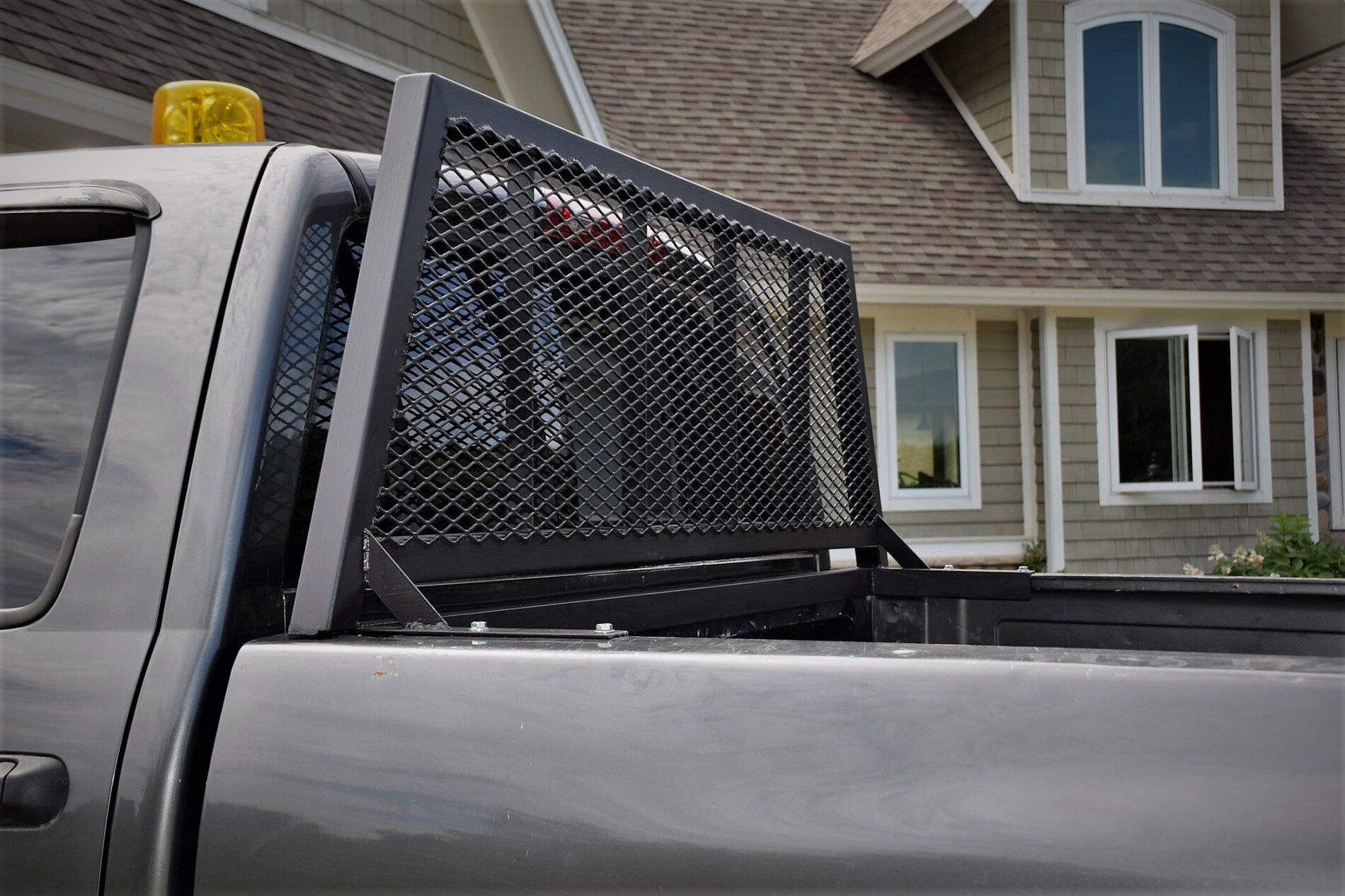

After breaking my 2nd rear window, I ordered the replacemant, but told myself I couln't install it until I bought or made a headache rack. After seeing how lousy the cheap ones are, and how stupid-spendy the good ones are, I decided to make my own. I bought square tube and expanded metal and after making a cardboard mockup, I started cutting and welding.

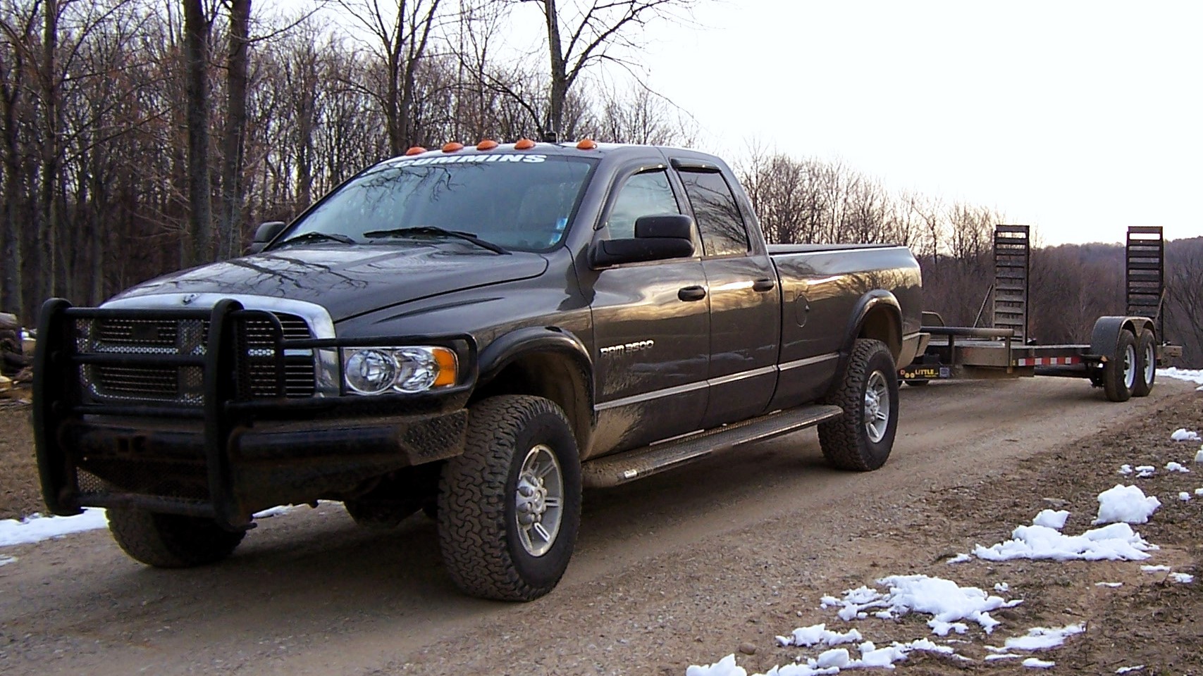

I did have wheel to wheel running boards on my '03 longbed quad cab.

Nice Truck! Great running boards also. Are they out of the box or did you just make them fit?
They look nice I called them up and got a quote for what would fit my truck and we're looking at like anywhere from 12 to $1500.
The super fancy ones with the saddle bins we're going anywhere from 500 to 750 even though I'm not a fan of that look I was trying to avoid even spending that much money if I could avoid it.
I was thinking more along the lines of something that would fit the area that I could use essentially stock brackets or otherwise attainable brackets to make fit or something that's advertised not necessarily to fit the truck but you know it'll fit the truck or just get some running board stock and make it work.

I've never seen a factory cowl hood. I expect someone here might have actual data, and bet Ram designed the engine compartment with plenty of room to expel hot air out underneath, and any vent/extractor on the hood will only make your truck warmer inside the cab.

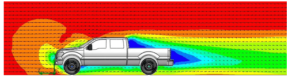

Perhaps that's true aesthetically they look pretty nice and the idea behind it is that underneath the vehicle is high pressure air and going over the top of the truck is low pressure air so that high pressure air that's trapped up under the hood on the highway in particular would be able to run over the top of the slipstream which should give you less wind resistance as well as drawing more air through the club sandwich of coolers that we have up front.
Remember I'm talking about prepaints right now and like I said it is a company called key parts that sells these 2 in cowl hoods with a windshield side exit only not a scoop in the front I'm not trying to make the truck look like an SRT-10. Just make the hood look a bit more robust although based on what you're telling me if it has no value whatsoever I suppose I could skip it I'll at least consider skipping it what I'd really like to find is some method to use wheel to wheel running boards for my truck that doesn't cost $1,000 maybe something in the DIY category or maybe something that is meant for another year of truck or maybe something that's meant for another truck all together or maybe just something that's available that we can utilize brackets and put on there I'm just not trying to spend $750 bucks to even $1,500 on some running boards or side steps or I think your company out there called n Fab makes what basically looks like it a bar with three saddle bins on it and those saddle bends are where you put your feet the third saddle bend of course is near the rear wheel so you can take a step up into your cargo bed I like the look of having a continuous wheel to wheel side step of some sort but there has to be a better option and options for this year and configuration of truck are somewhat limited which is why I was thinking a little bit of personal touch or if we know something that will generally work or somebody simply has found something that I don't know about.
I can't argue with aesthetics. For better cooling, I'm no aerodynamicist but I think the only way you get air stacked up under hood is if you close the bottom too; in a truck this heavy you can move a lot of air out the bottom without causing front-end lift. If speed builds air pressure underhood temps would tend to go up as speed does, but all of my cars and trucks have better AC and cooling performance at 50 mph than they do at 5. I have a car with an airdam designed to limit air going under the car which draws more through the cooling stack with no hood opening (I had to add a thermostat just to get oil to operating temp, and even though it makes 16% more power than stock oil still runs at 180-190F even at 4000 rpm, AC on, in 90F ambient) but it's only 3.9 inches off the ground. This drawing suggests the base of the windshield is low-pressure but I believe on old desert racers and stock cars they used this for the air intake as it was cooler and cleaner.

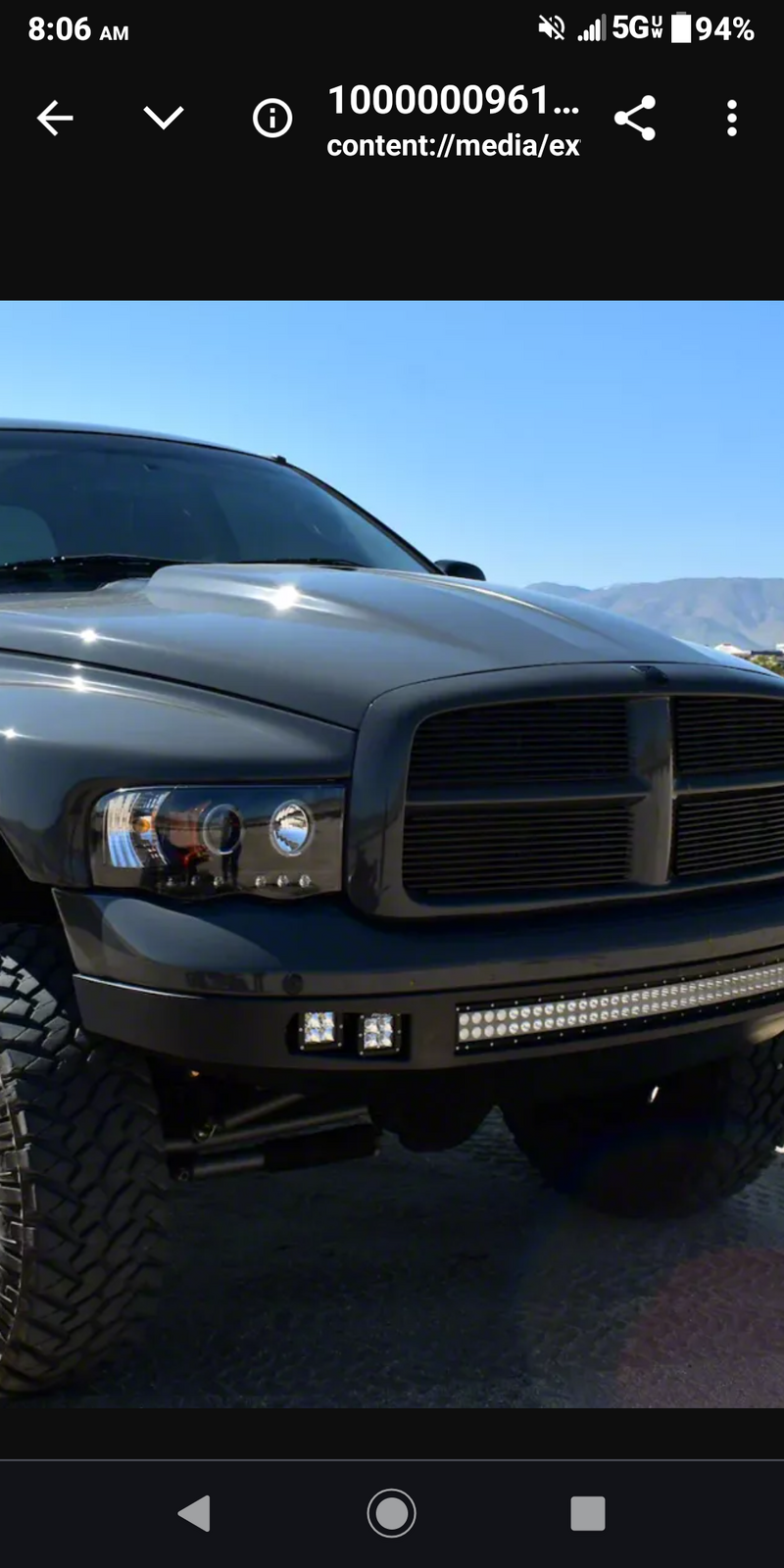

Interesting concept the airdamn. I have a Steel Bumper replacement the same as this person's truck in the picture. Probably will not accommodate one. My ECT runs a bit hotter unfortunately even after anew fan clutch and I did a head gasket recently. The radiator is new and have the banks intake. I am in Tampa and my Intake air temp gets pretty high. But my ambient temp is like 100 and I run an aggressive tune.. Though of the Banks scoop for my Banks box but not sure if that will fit either. But I digress.
I'd like to pull more air through if I could and I know why we have cowl flaps and such on our recip planes and that is for ground running and when the engine temp is up to let more air through the engine and around the cylinder fins (air-cooled.)
