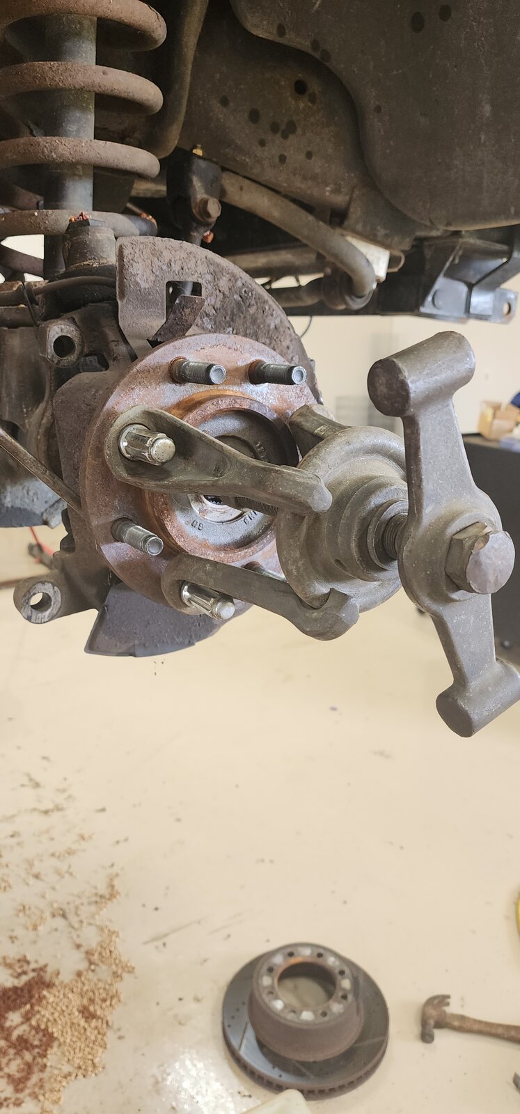

Just so happened to have this bad boy lying around....
Hmm, Intresting but also puts a ton of stress on that U joint and axle shaft which is not what keeps the hub from moving, hope you are replacing that u joint?
I'd much rather replace a U-joint than the ball joints. Using the power steering method finished off my lower ball joint on my old truck and I've talked to a couple others that have done the same.
Ok lets think about this..
The hub has internal splines on a 4x4
That means the ujoints have zero lateral connection to the hub except for the spindle nut.
The major physical connection is the splines.. for drive.
By pulling on the hub there is zero load on the ujoints.
ON EDIT, I WAS WRONG. IT IS PUTTING A HEAVY LOAD ON THE U JOINT

Since I'm about to tackle this job I'm interested in all methods of hub removal.
Aren't you pushing against the axle shaft with the center bolt of the puller? I'm not understanding how the u-joints aren't being (over)loaded by that puller.
OK yes I wasn't considering that I was pushing against the axle shaft and yes it does transmit through the u-joint. My bad.
The u-joint is fine but I can see where it could get damaged.
These hubs have been pulled a couple times over the life of the vehicle so they aren't as bad as ones that were never pulled.
The puller I used seemed to be easy on the joints as I slowly tightened it and smacked the back of the hub flange to help it move.
So I digress and recommend using the socket and extension and the power steering.
