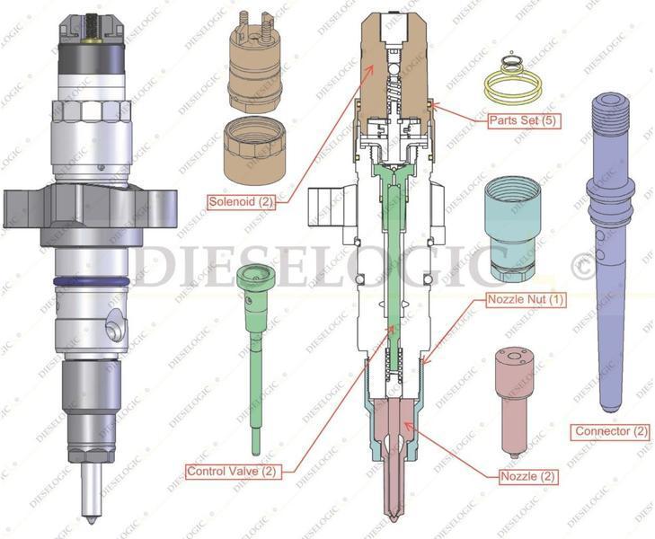

I was lucky. The one I changed out had the ball and set screw already in it. The two new solenoids would need changed out. I threw away the old solenoid. I would love to dis-assemble it and see how it fits and know the set screw size. One o ring is in the nut. One in the top in an indent and the lower one is one the injector body as I recall that the nut slides over. You can see both in the center of the attached photo. I've attached a different picture I saved to give you a better idea. I coated the sides of the new solenoid with a light coat of vasoline to help it move easier. Make sure you don't loose the injector spring that stays on the top of the injector.

There are two solenoid sellers now on EBay. The one that includes the o-rings needs the ball and screw moved from your old one. They are Bosch type. Nice! The other company sells without new o-rings but are ready to install using existing o-rings. The ball and screw already in place. After installing new solenoid, start your engine either way with the valve cover off and watch for any fuel leaks on the solenoid nut. I don't expect any but the engine oil stays put and nice to see it's not leaking diesel before the valve cover goes on. The nut is pretty snug on the solenoid in two spots. Let me know if you can't find the solenoid on EBay. I looked it up as Dodge injector solenoid I believe. At about 72 bucks each is a bargain! I hope the bad one is cylinder 1-4 where vision is better on the first run. Be sure to lift off straight up the old one and don't knock off spring. I'll sell you one if you don't find any for sale. Good luck, Herb
