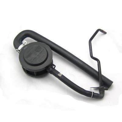

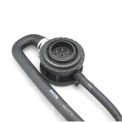

The absolute best solution... if you can find one and stomach the cost... is Fleetguard's Crankcase Ventilation Kit part number CV50115. This contraption replaces the original vent. It collects and drains oil vapors back to the oil pan so there's no more oily film anywhere on the engine or dripping on the ground. I'm pretty sure they've been discontinued by Fleetguard, but a few are still available if you do a web search.

The Fleetguard system still has a tube open to the atmosphere to vent pressure and moisture. It simply does a MUCH better job at separating oil vapors and returning them to the oil pan. There are no oil drips from the vent tube.
Ridiculously expensive, but works outstandingly well.

I originally installed one of THESE (similar) breather tanks down low near the frame and oily vapors still blew out from the mesh vent on the tank coating the underside of my truck. What's worse, I still had drips, but now coming from all the oil running down the sides of this new breather tank!
That's when I gave up and spent the money on the Fleetguard kit.

No. The entire assembly mounts in place of the original right on the front of the engine on the timing chain cover. There's a narrow metal tube that connects the new vapor separator down to the oil pan so any condensed oil can drain back to the oil pan.
