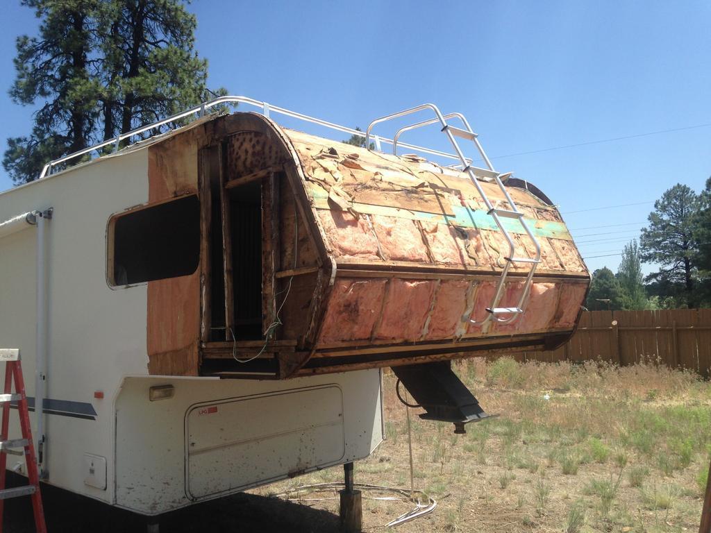

is what you get with a leak undetected for a year.
