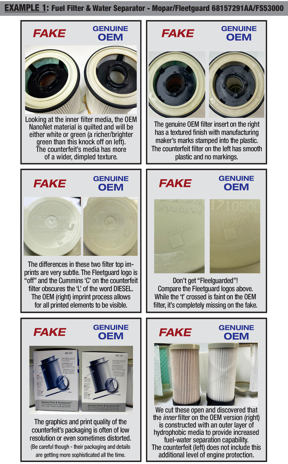

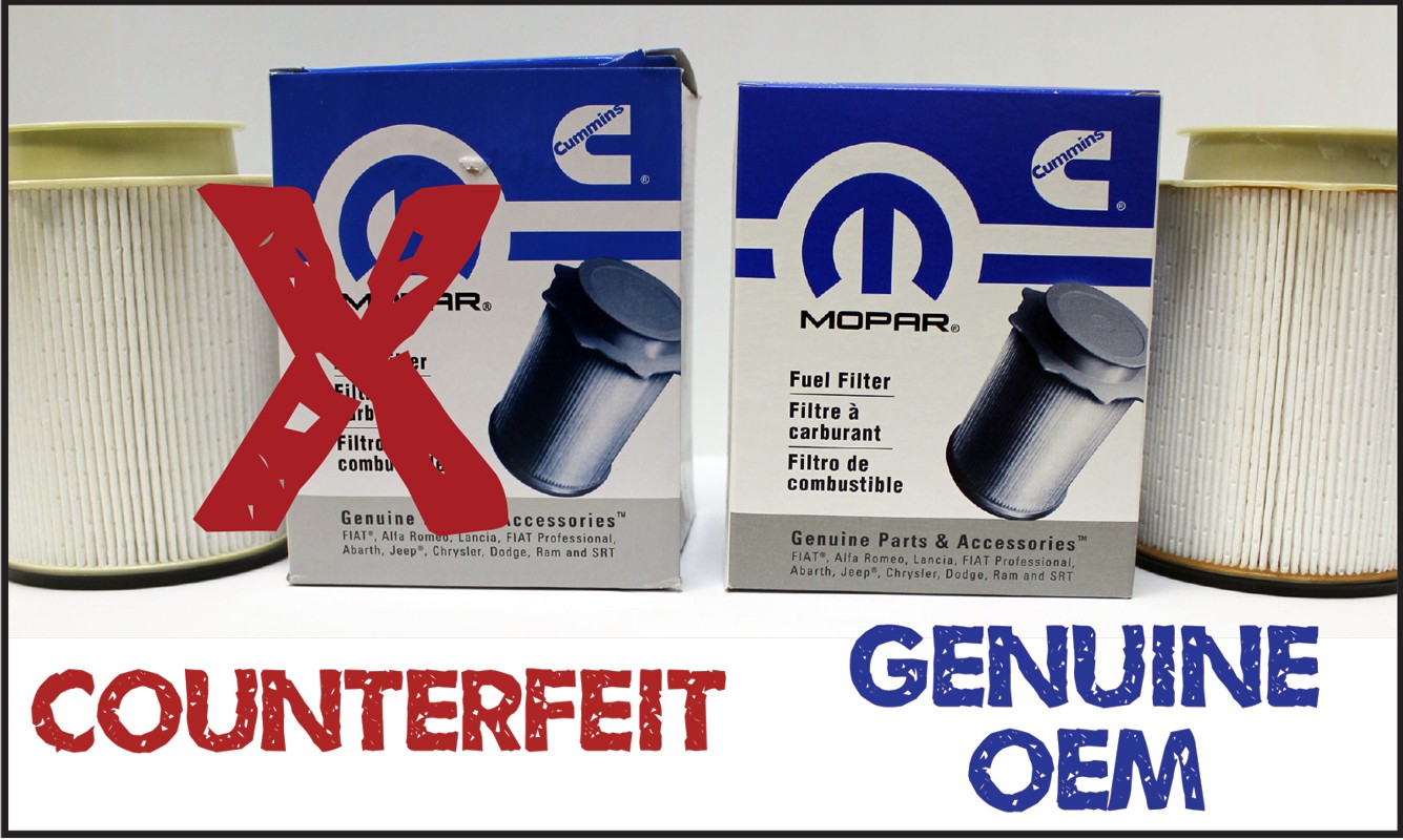

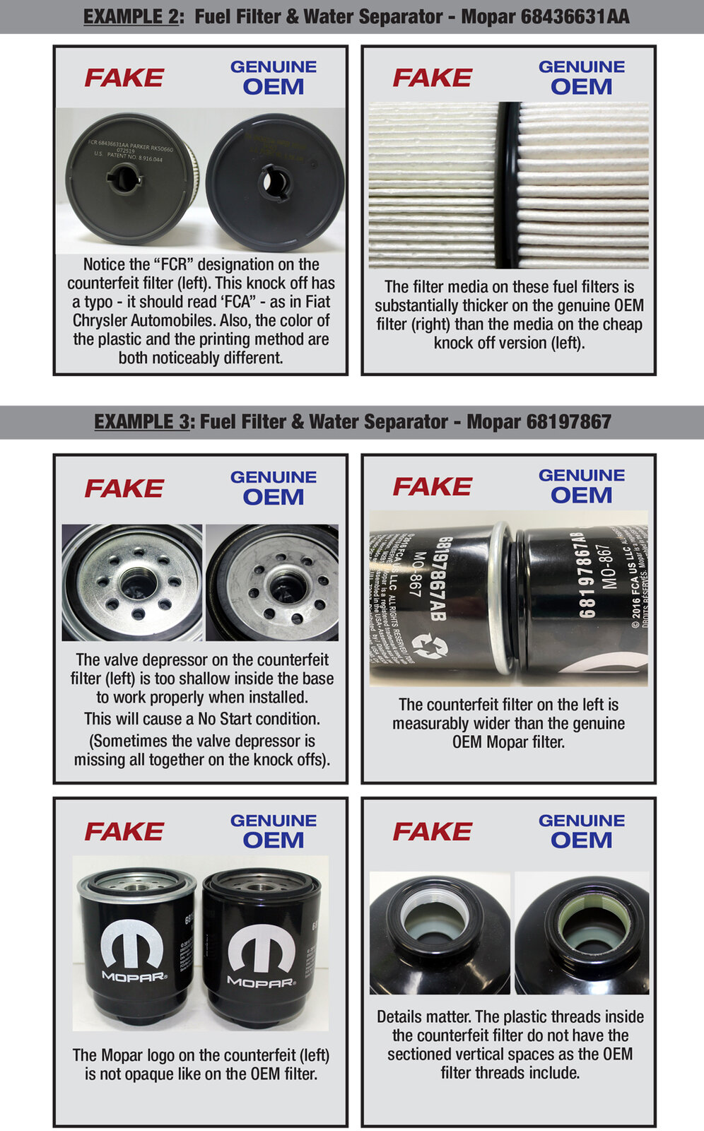

GENUINE OEM VERSUS CHEAP KNOCK OFF FILTERS
Geno’s Garage staff went shopping for filters online so they could see for themselves about the fakes out there. Below are three examples of legitimate OEM filters compared to the same part number but counterfeit and cheap aftermarket versions. (Note, this is by no means an exhaustive study and these examples are focused on counterfeit versions of OEM filters).

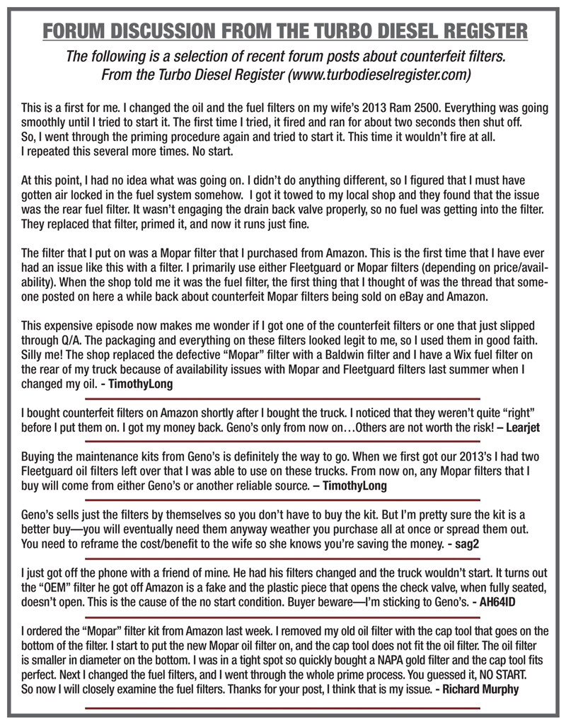

OTHER DISCUSSION
Hand-in-hand with the information from Geno’s Garage, we found many TDR posts discussing this issue. The insight from truck owners gives you the “real world” details.
Here’s a sampling of some of the posts we read:

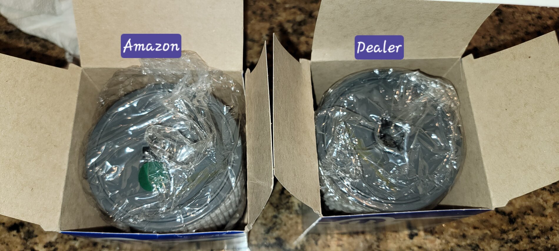

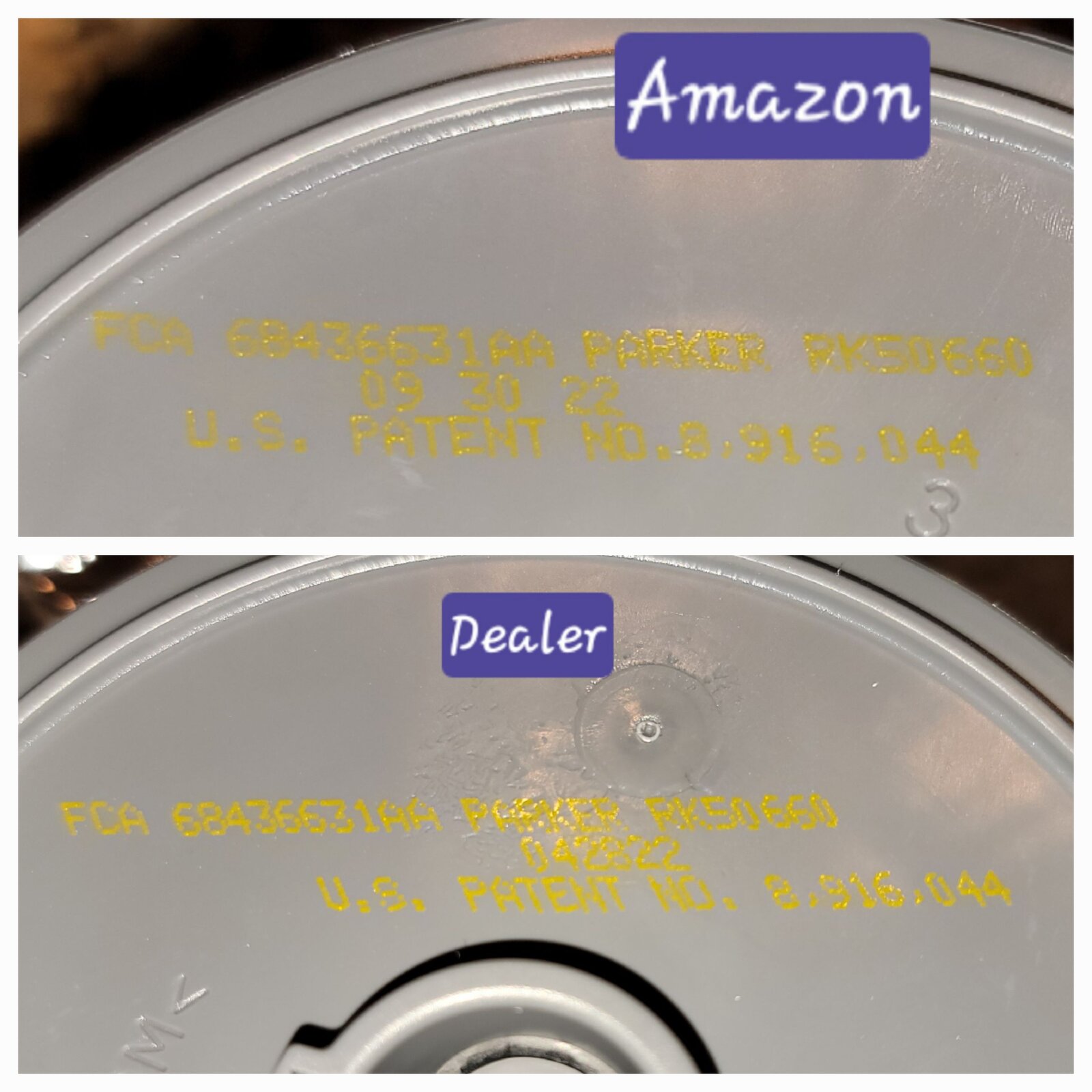

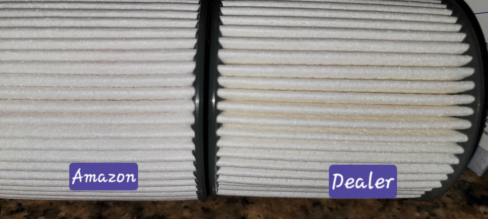

I bought an 68436631AA Mopar 6.7L chassis filter off Amazon and a local Dealer, as shown in the OP above.
The AMZ had a green dot on the bag and the dealer did not.
Not a big difference but the green dot has to mean something, could be a simple 2nd shift assembly vs a 1st shift assembly, or a darker meaning like it had a flaw on the green sticker. If I were to use a color system I would invert the colors for sure not mark a defect in red or yellow, if it was still sellable.
I ordered 2 from Genos they will be here early May, which is the only reason I have the dealer and AMZ filters, so will we see more dots or some other magic markings, stay tuned.
Green Dot on left bag.
