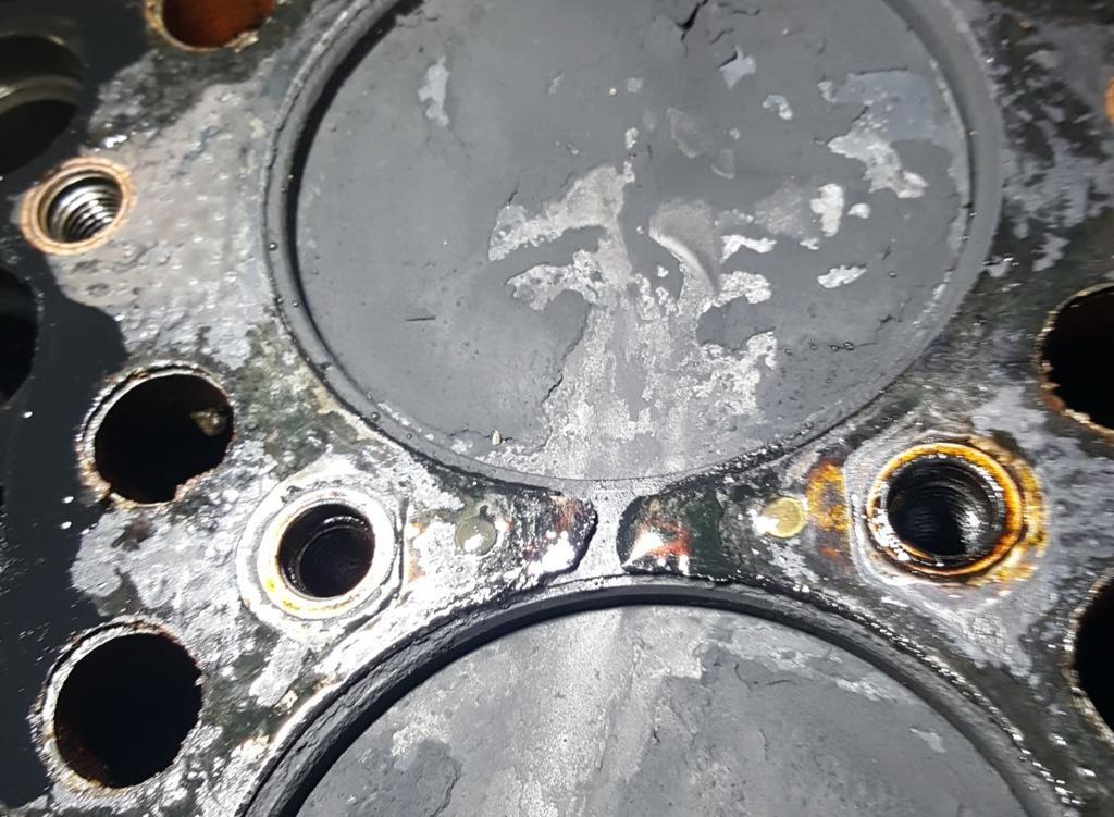

Can anyone give me specs on a Kubota V1702 engine for deck straightness? It's blown the head gasket between cylinders 2 and 3 and I'm measuring 2.5 thousandths (tight) under a machinist's rule. 2 thousandths slides under easily and 3 thou won't go. I'm leery to just throw a head gasket on it and run it. It got a new cylinder head 5 years ago and has had pretty hard usage since. Any ideas?
I just skimmed through a Yanmar manual out of curiosity. There was no flaness spec given for the block, at least that I could find. My gut tells me .002". Interestingly, the standard for the cylinder head is .002", but the limit was .0059"! Do they even offer a shim gasket if you were to deck it?
I was able to find some generic Kubota info at my local machine shop. They give spec of .002 for the block and the same for the head. The head is almost .005 thousandths warped so its getting surfaced right now. We are going to roll the dice and throw a new head gasket on it and see what happens after the head is resurfaced. This engine is kind of a ba$tard child engine as it's in a bobcat and Kubota won't help me out with parts or anything. Matter of fact, the goober parts kid tried to tell me there is no such thing as a Kubota V1702. :-laf

Sounds like a plan, Don. If the head was that far out, as long as there is no erosion of the deck where the gasket blew, I'd feel pretty confident in that repair.
