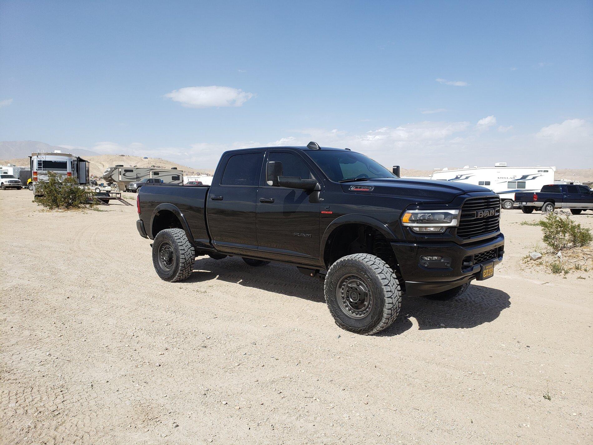

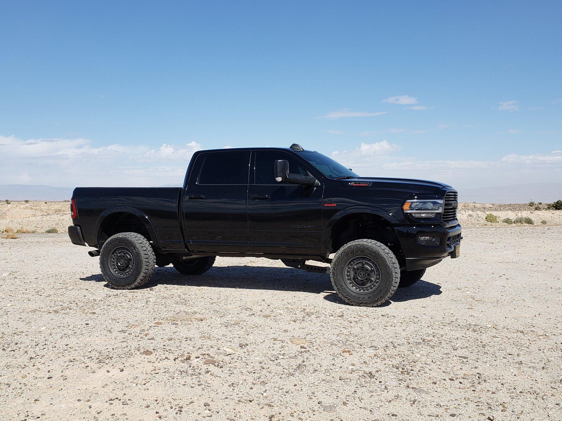

So I ended up going with a 6" Ready Lift kit & 35x12.50 Toyo R/T's, I have had it on for 3 months now. I love the setup, absolutely no issues, rides on the highway just as well as it did when it was stock. I have taken on some trails and out to the desert, with no issue, even ran it a little hard down some woops, did very well. I am extremely happy with the setup.
