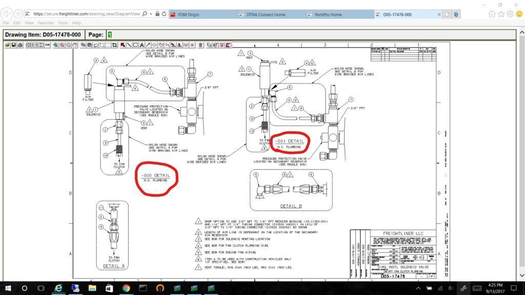

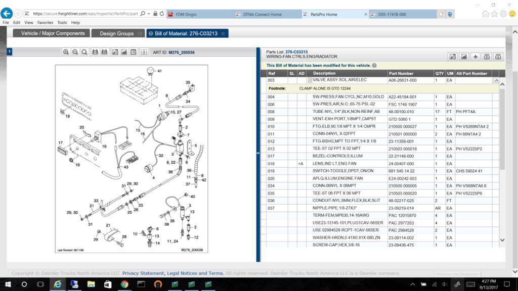

There are two 12 Volt air solenoids used on the older Freightliner Trucks to control air fan clutch engagement. One is normally open and the other normally closed. I don't see why one of those would not control the brake in lieu of the $300.00 Jacob replacement.
A06-26661-000
A06-26661-001
At another location today and tomorrow, have schematics drawn up by a tech in my notebook that I will dig out Friday when I return to Bangor.....
Parts diagram...
Engineering Diagram...
