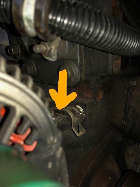

Unsure of what I am looking at here.
on a 24 V. Behind the alt on the block,an angled hose of some sort?
It is probably OE on my '00 and is pretty cracked and worn. Need to replace...
Thanks!
I believe that is the supply line to your heater core but can't tell 100% from that picture.
If you follow that line where does it go? Through the firewall?

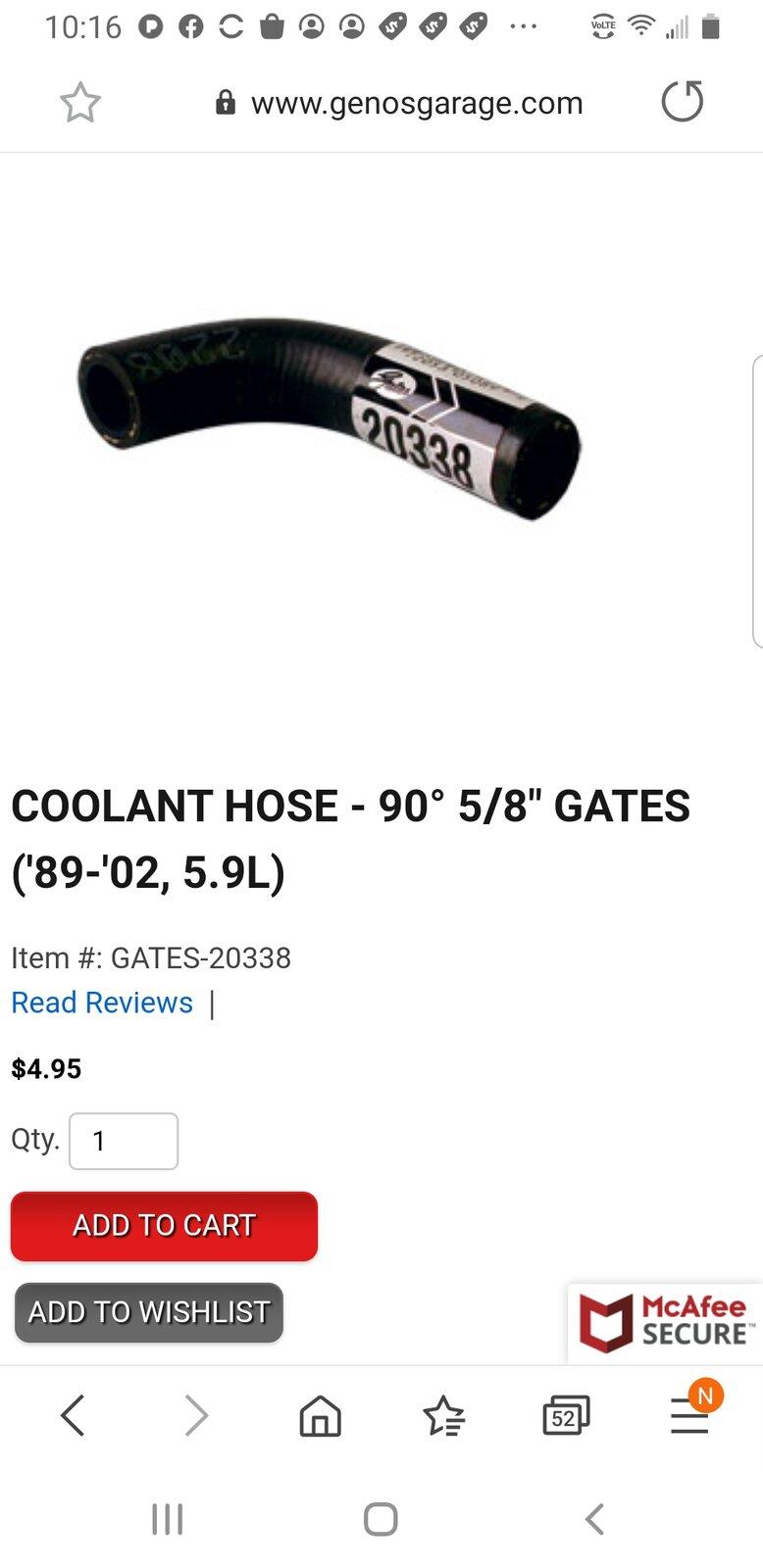

If that one's cracked, I would change all of them, including the straight ones (5/8.) There's several in my 12v. The only one I haven't changed is the one in the back of the block. I'm almost certain this is the one at Geno's Garage.
