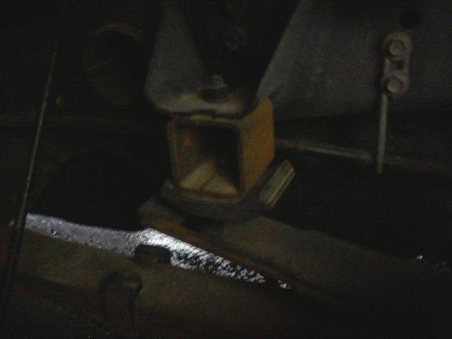

I added 1 ton rear springs (The overloads from a 3500).
Still going to squat too much, because the overloads will not engage soon enough, unless you do something like this.
