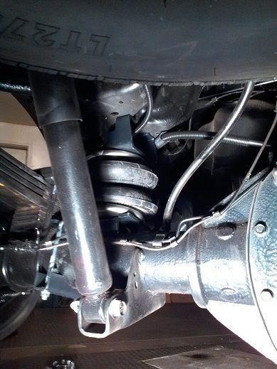

I chose airbags with the handheld remote control, you can either run the bag pressures together or individually....bought them to level me up just that little bit to keep headlight adjustment correct when towing the fifth wheel....then bought a used Lance slide-in...that's where the air bags really shine....

I'd go with air bags but throw out the "quick connect" fittings that come in the kits and buy proper ones with furls and inserts and you will have a more durable air system especially if you get into fairly cold temperatures. With bags you can actually adjust your height by air pressure unlike Timbrens which are a set height.

I have had both and would much prefer the air bags. Ran with the bags for over 8 years and never a problem. I did not have the on board compressor, just aired them up to level when I was hauling and bleed them down to almost nothing with an empty bed. Timbrens were pretty harsh loaded or not.

I have a custom rear spring from Carli suspension that is progressive and airbags to end up with a great ride under any load.The bags have separate plumbing side to side-helps prevent the sway with high center of gravity and can fine tune for any irregular loadingI can only imagine the degradation of ride quality sitting on a bump stop all the time,no timbrens in my future.
