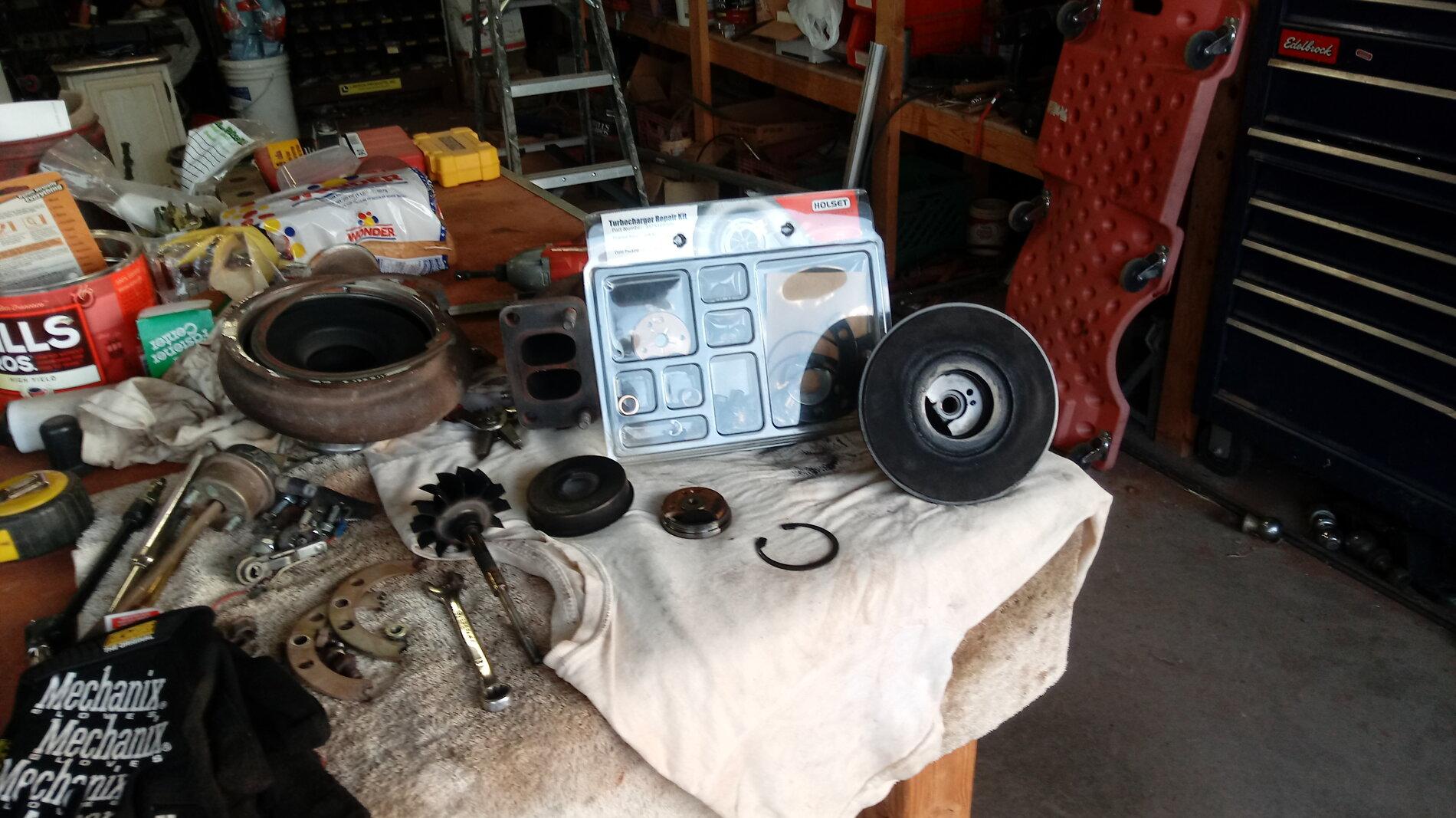

If you are in doubt you might want to put a rebuild kit in it. Mine was used a lot harder than yours. 12 years with EZ and RV injectors then 5 years with an Edge Juice. So 17 years pushing 33 psi boost, a lot of miles. I used a Holset rebuild kit @ about $80.

I'm running an HE351CW I bought from a fellow on here 10 years ago. I had put a Sled Puller 66 on mine and sold my HX35. Then I sold the 66 and the big injectors and needed a "stock" turbo. The fellow had replaced the HE351CW because he thought it was worn out. It was dis-assembled when I got it. I had the WG port enlarged, rigged up a spring on the WG arm, put it back together, and slapped it on. Been going strong for me for the past 225K miles.
