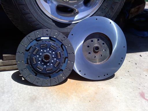

the exhaust brake does not effect the nv5600 in any way, the disc is affected, the spring's are setup for heavy torque in the forward direction with only compression torque in reverse, the good brakes like the pac or bd add 165 hp to the reverse load. after many miles of heavy use the rivets holding the center section wear into. we have peter at southbend build the disc using a center piece for a clutch using a engine brake. attached is a pix of one that this happened to and left my driver stranded in Oklahoma. use a blend of royal purple synchromax and sae 50 wt synthetic Transmission Fluid like delvac from ww granger or castrol synguard from o'rileys. you need to overfill the transmission to lube and cool the rear bearing and some upper shift parts, we have transcools on ours so they hold more fluid than yours. i think without the trans-cool ten quarts will be about right, this is double.

CKelly1, are you saying that the spline slipped within the 4 rivets that clamp it down in the center? I'm not seeing the damage.
I don't see the damage either. That is a picture of a bone stock clutch, I don't think I would use one on a modified Cummins. In all fairness mine lasted 210k miles. I changed to this one, note the beefy hub. I use the exhaust brake all the time and down shift.

Just for grins, take a look at an OE stock style disc damper. It has 6 stop pins that hold the damper assy to the drive plate. They are at the outer edge. Now, look at the edge of the damper at a stop pin. See the hub flange? Notice that it is about 1" from the flange to the edge of the stop pin and about 1/2" on the opposite side. The 1" is the range of damper spring compression in DRIVE, the 1/2" is the COAST direction, easy peasy. Now look at the edges of the stop pins? See any witness marks, are they just a touch or slightly notched or really notched?
No marks, never fully compressed the damper. Just a witness mark, you touched it a few times. nice imprint? you've held it on the pins, fully compressing the damper springs. Deeply gouged, been having some fun ain't it grand.
One other damper reading issue, if the hub pilot is washed out and all loosey goosey, got pilot dowel sleeves in the engine to trans adapter plate? Missing dowel sleeves don't allow the damper to float and relax, causes premature damper failure. That disc does have a floating nugget hub and it will feel loose if you put it on a shaft and check it at the facings.
Dowel sleeves are critical to the long service life of the torsion damper, pilot bearing and even the input shaft and trans bearings.
