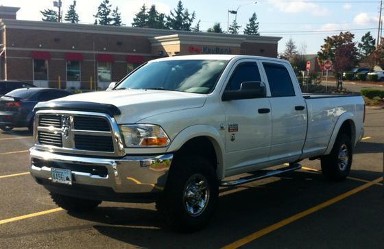

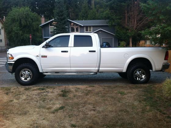

I have a 2012 full size 3500 crew cab. I did the Leveling kit and added slightly beefier "meats". I went with 285/75/R17's and love the look and feel so far.
I did the simple thing and just took my truck to the Les Schwab shop and had them do the lift and tires. Again, I love the look. The ride is still nice...
here is a pic of how it looks like now ... .

Thanks for the replys. EDGARCIA beautiful truck, thanks for the photos. I now have a starting point for my jump off of stock and to standing tall.
