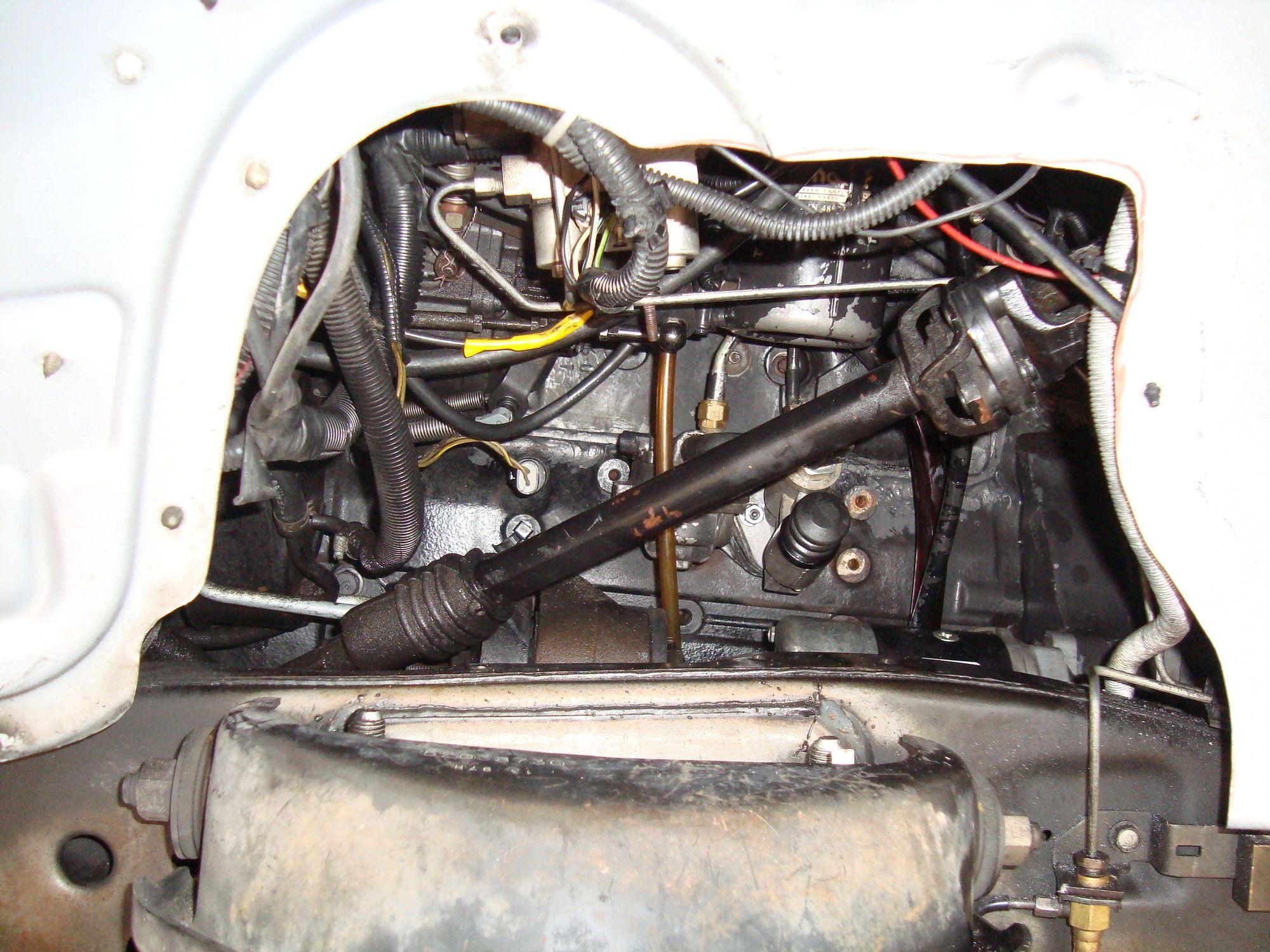

I go in from the side.
pull the fender liner and cut an access hole/notch,,makes lift pump work do much easier,like it was said,the liner covers it all up,
