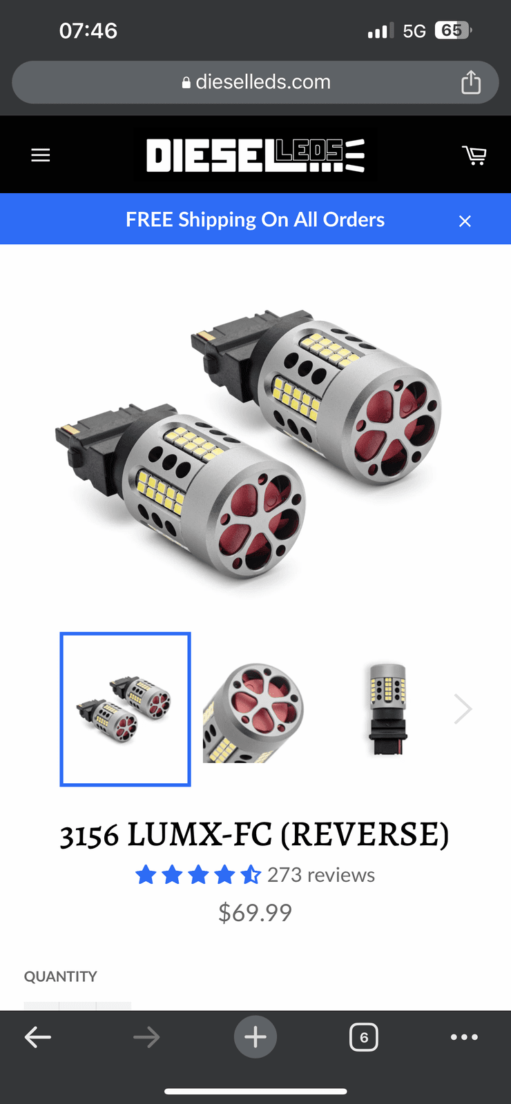

Just recently installed some diesel led Lumex 3156 reverse FC bulbs in my reverse lights. Factory bulb is a 3057 and after much research, the bulbs are interchangeable as the 3157 are a tad longer and much much brighter but use same sockets and pins. 2k compared to 600lumens. This said
can I swap my tail light, brake/turn which are all 3057 to the 3157 bulbs. I understand there will be a greater power draw but being LED versus dual filament halogen I can’t see it being much. My only concern is having a circuit style plug rather than individual wiring and drawing too much power.
or should I look at 3057 LEDs? Any recommendations? Lasfit doesn’t sell them and neither does Diesel leds.
Stay with a 3057 LED bulb. Changing it to a different bulb could result in bubbled taillights or melted sockets. Keep in mind that an LED bulb may not draw as much current but can generate a lot of heat! That's the downside to LEDs. LEDs offer a brighter whiter light to see by and allow factory wiring to handle the current load. Not sure if you'll have a bulb failure message or not. The next thing on the truck to add list is separate reverse spot light to aid the lighting in reverse! The factory lights don't offer much. o_O

Thank you. The lights I mentioned above have a built in cooling fan in them to aid in heat dissipation (forgot to mention that) lol.

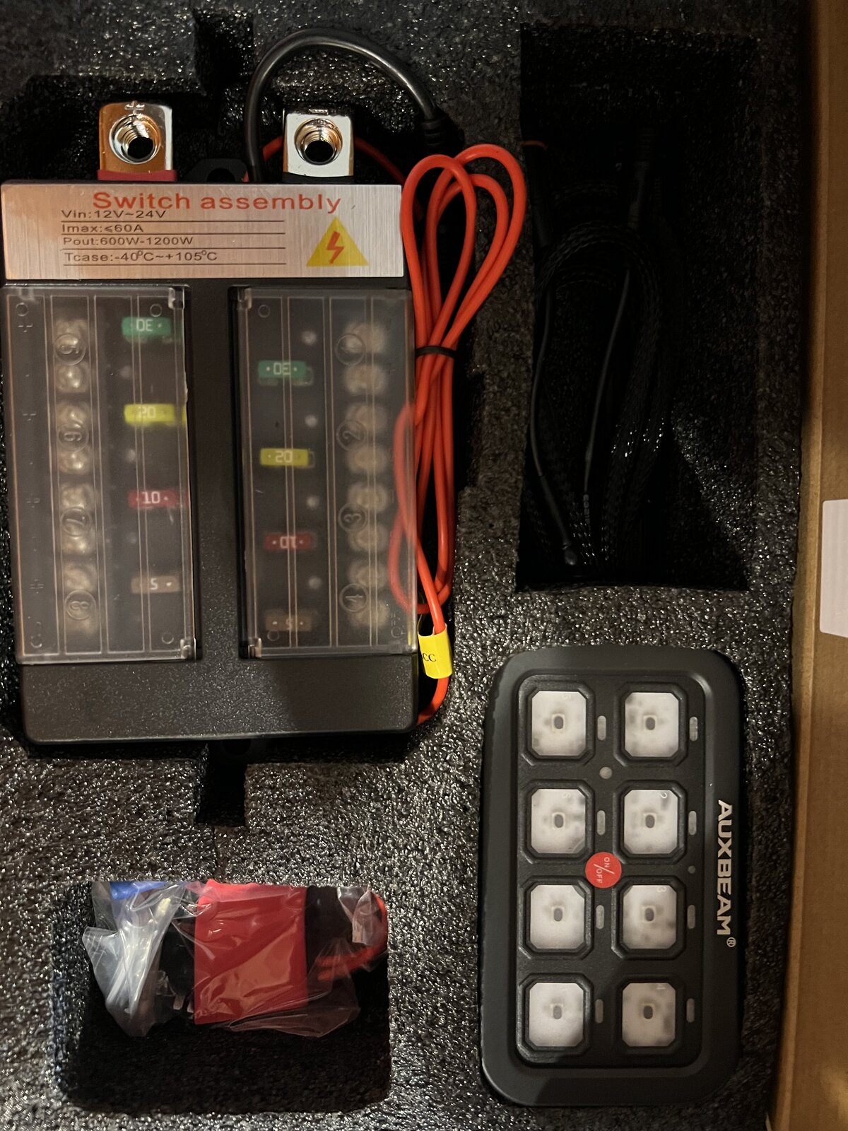

So I’ve got a harness that I can use for spot lights and such with a switch. However I’ve also got my auxbeam 8 gang switch panel from my old truck that I never got around to installing.
Only issue with that is the length of wire I’d have to run from rear of truck to the engine area. The gang switch is fused to the battery and has its own setup. Will likely do this if I can’t get it the way you suggested. Just have to do the math for length of wiring needed plus power draw.
@Randomrunner12, Just run a piece of 10ga for power to the rear. That's a 30 amp load and the truck length is in the specs for that wire rating. I like the relay option as you don't need to turn on a switch, but you could run a hot wire on switch to the NC terminal to turn rear lights on if needed. That's an option that I was looking at to see if it would be needed. I'm leaning towards that for hooking up a trailer in the dark, along with even loading the truck.

I have a pair of Rigid SRM Diffused backup lights on my truck that draw 16w/bulb. They only need 5A for the pair, so 10ga would be more than enough and what size my Aux Switch wiring is.

@Topzide, That's why I am installing that AUXBEAM panel. Its an 8 gang fused switch that connects to the battery VIA 2GA wiring, but also has an ACC on power wire that connects to the fuse panel. Then I can install any extra's that I want and control them in the cab with just the one panel and not have to run dozens of wires through the firewall. My plan with some of y'alls advice is to run some 10ga wiring from the reverse lights to the gang panel and then I can have both on when I want rather than every time I reverse. I also plan to install some pods on the hood corners for off-roading and trailing.
