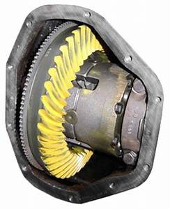

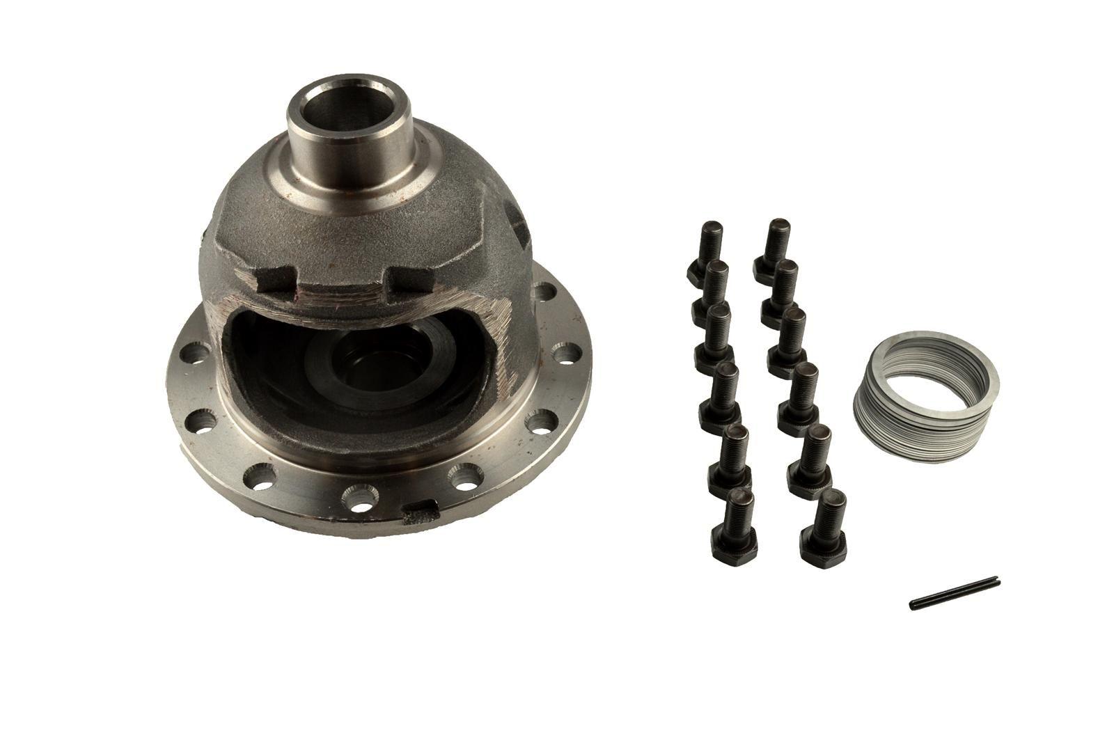

If you want to buy the oil prior to pulling the cover, just get the oil with the additive in it, it will be fine in an open diff. Top picture is open, bottom is limited slip.
