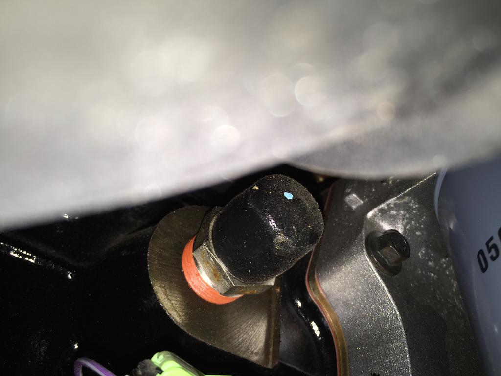

In the picture below there is a 3/4 NPT pipe plug with orange sealant on it just below the second from the right piece of green tape. The green tape is covering the exhaust ports.That is where the block heater goes. The oil cooler and cover, to which the filter attaches to, goes in the empty space just to the right of the plug. This picture shows the right hand side of the engine. Sorry this is the only picture I had readily available. Hope this helps
