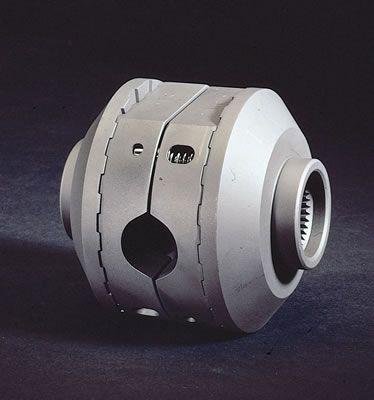

So having done a few searches, I found out that the Powertrax is now made by Richmond Gear, which from what I have read is a good thing.
Question: Why is the Powertrax from Summit different from the Powertrax from tellico4x4.com
Summit:
Tellico 4x4:

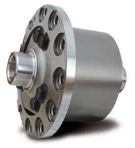

Next is the Detroit True-Trac... Bolt-In? Somehow, I have never changed carrier Bearings without the fun and games of shimming, and setting up the other stuff. Anyone done this? It seems that although more expensive, the Detroit TT is the best option.
Detroit True Trac (Jegs)
Anyone installed one of these? Pros / cons? Thanks.
