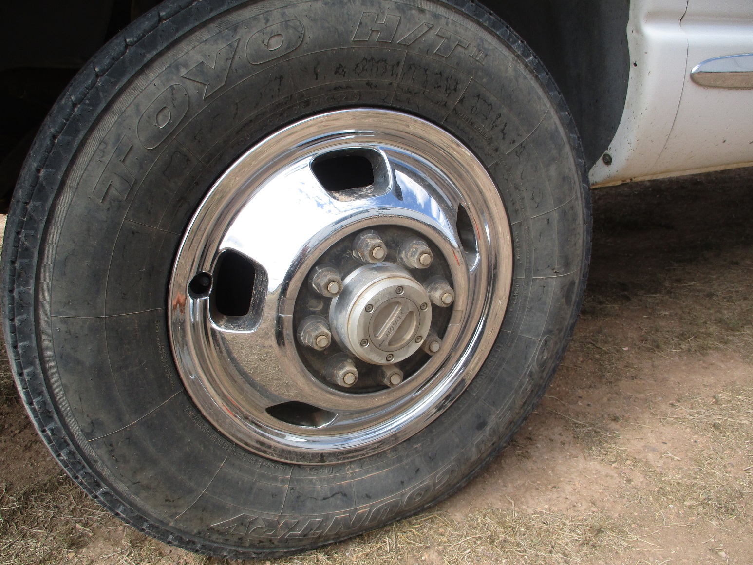

I've been looking at installing locking hubs on my truck. I want the 2 Lo (as you guys call it) option.
I'm thinking of this product, any comments?
I'd also like to keep my stock wheel cover's any ideas on how I can accomplish that? ….. aftermarket center covers?

Water jet is the only way I figured out to cut a hole into the chromed center cap. On the lathe it didn't work, shattered the whole thing into thousand pieces.
There are non chromed center caps where a hole saw will work just fine.
hey ozy , i too installed the spintech hubs,, used the factory covers,,, cut hole in them with my grissely metal lath,,,, used 4 jaw chuck,, just have to cut reeeal slow &easy.
p.s. also when i got my hub ,, i drove over to ohio a d picked them up,,,,paid 1450 for them,,,, my how times change,,, also how do i add my truck info at the bottom?????

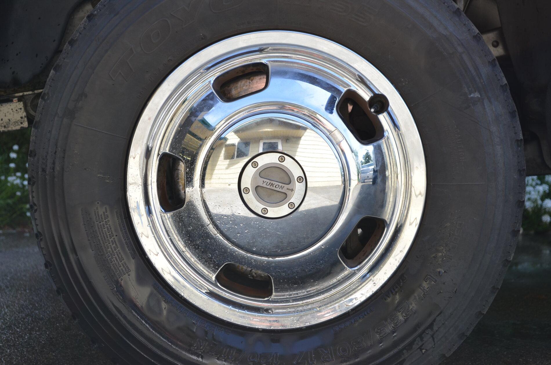

These went on back in 2013 which is when these pictures were taken, but I cut the center caps myself with a new hole saw. They look better in person than in the picture. IIRC, I found the center, drilled the pilot from the back, then started the hole saw on the front using the pilot of course, after about halfway through the plastic I finished the hole with the hole saw from the back- if that makes any sense.

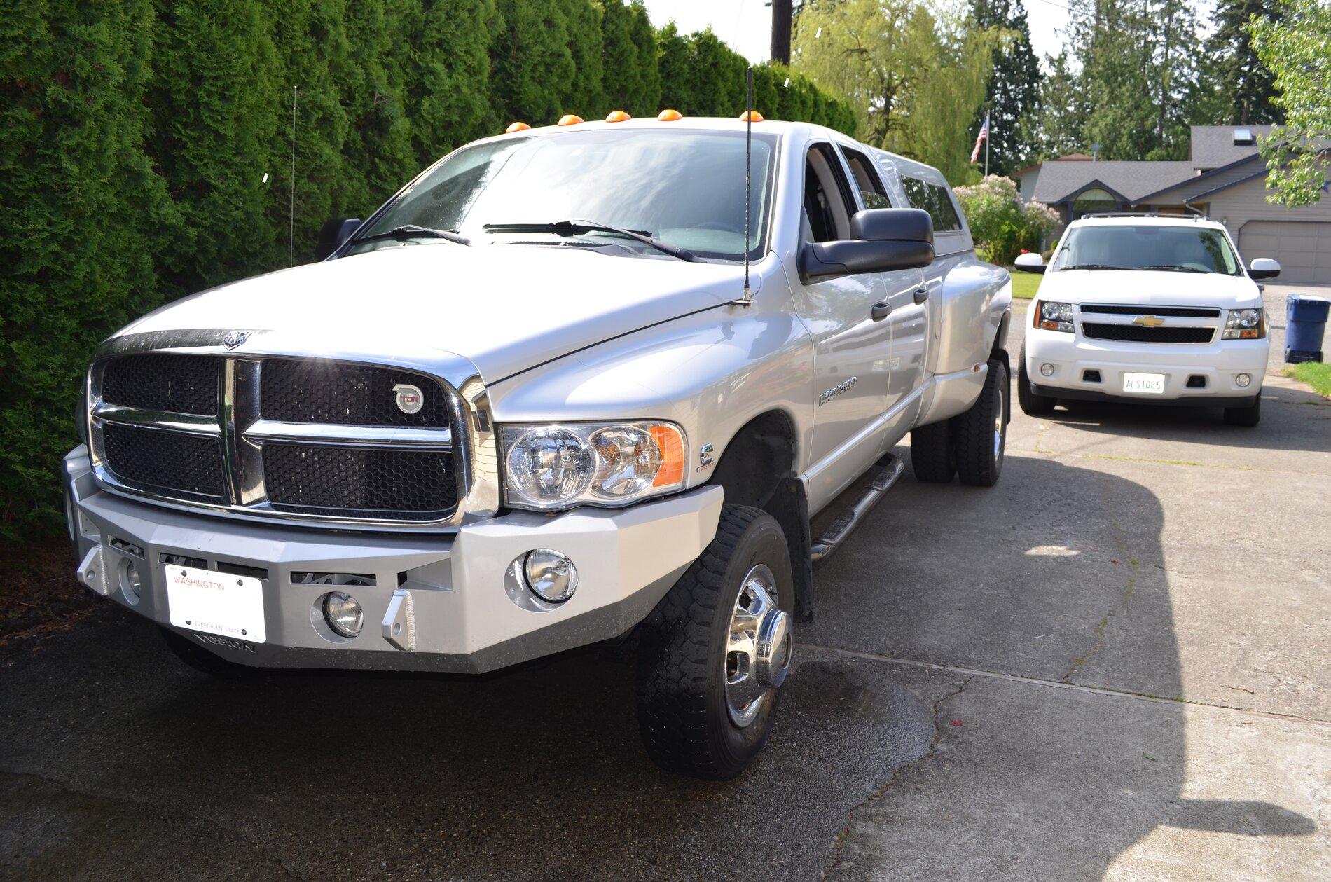

Sorry it's taken me forever to update my post on this subject matter. I ended up going with a Yukon Free Spin Hub package for my truck (05).
Yes, it was pricey but I wanted the best and after spending a fair amount of time researching free spin packages Yukon was the way to roll.
As you can see I ended up not having to modify the center cap as the Yukon package just doesn't protrude very far outside the wheel.
I can tell you that this mod was well worth the money. Having the two-low option pulling my big hauler is the ONLY way to roll ... =)
