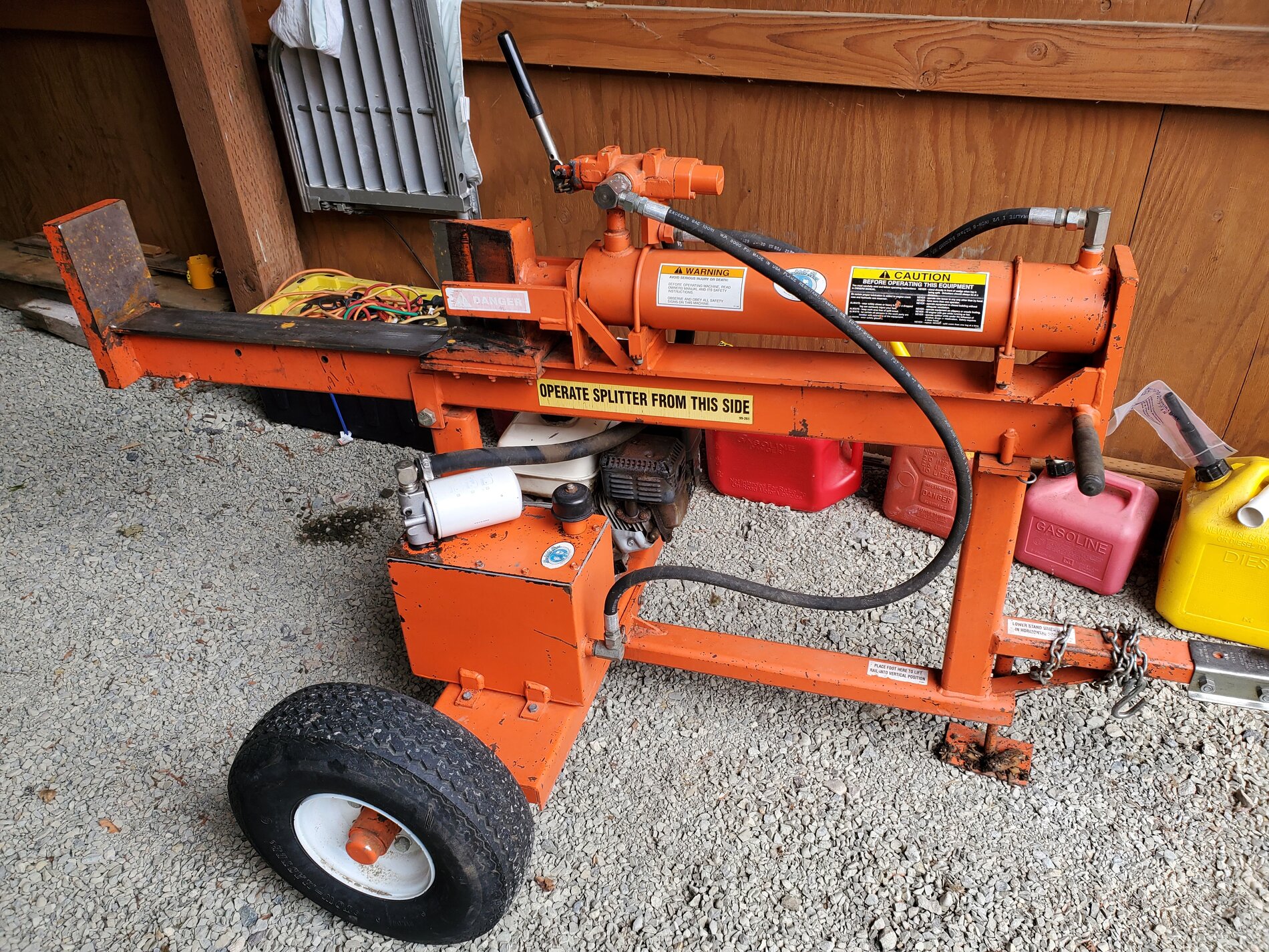

I know some of you are very knowledgeable about farm equipment so I am asking about a log splitter I got from my BIL, a Bachtold Brothers 5.5 HP Honda power, needs hydraulic filter and fluid change (pretty sure it's never been done in about 20 years of use). It's a spin on filter, are they pretty universal for threads and size? Numbers on existing: 03038 and 112214. What is the best and most long lasting fluid. I don't care if it's a little expensive if the quality is high. Synthetic or not? Thanks in advance!

I didn't find anything useful with the filter numbers, but I did poke around a bit on Baldwin's site for some guidance. Judging by the photo, my guess is the filter is roughly the size of our oil filters, and should have a 1-12 thread.
That hydraulic system appears to be a little strange. It appears to have the filter plumbed to the suction line. Most are in the return line. Maybe there is another line that I can't see.
I agree with the 1"-12, pretty standard. The Donaldson P151551 crosses to a Napa 1551, 10 micron. That might be too fine for the suction line. The 1553 Napa is a 33 micron.
