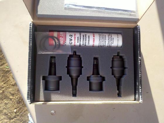

Got these yesterday. Now, is it something I do myself or pay a pro? They're so nice I hate to put them where they can't be seen!

Speaking from recent experience, if you can afford it, pay for a pro to do it. This is not an easy job! But, you always have the old adage: If you want something done right... Well, you know how that goes. Good luck, and you got some nice units there. Hopefully the last time you have to do this job!

It is a big job, but can be done. You can get a ball joint press from most of the big chain auto parts stores. I've done them more times than I care to remember on my 90, 95 (which I sold) and my 05.
I've done probably 8 sets, with the large OTC press it's pretty easy, but a normal automotive press makes it much harder.
Just did a set in my dads in his 03 and it was pretty painless, also a good time to check/grease your axle u joints and wheel bearing. It did help that my buddy let me borrow his hd ball joint press.

AMink, it took "4 forevers" to get mine after I ordered 'em. And after they came in, I decided to wait until I could scare up a little (gold) dust and do the Dynatrack/Dynalocks while everything was apart. I helped a young man at my friend's shop put mine in. The biggest problem we had was jury rigging spacers on the bj press. Maybe DNDracing can tell us a brand that does a good job. When you get the Carlis in, it would very much surprise me if you said that it was not money well spent.
