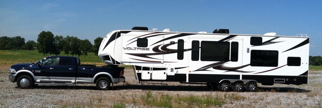

I pulled a 43 foot 5er with my 4th gen. No issues whatsoever. No flipped axles, no blocks, no nothing. Once hooked up with proper bed box clearance, the pin weight leveled everything on its own. Take the hour and a half drive and hook it up then make your decision.

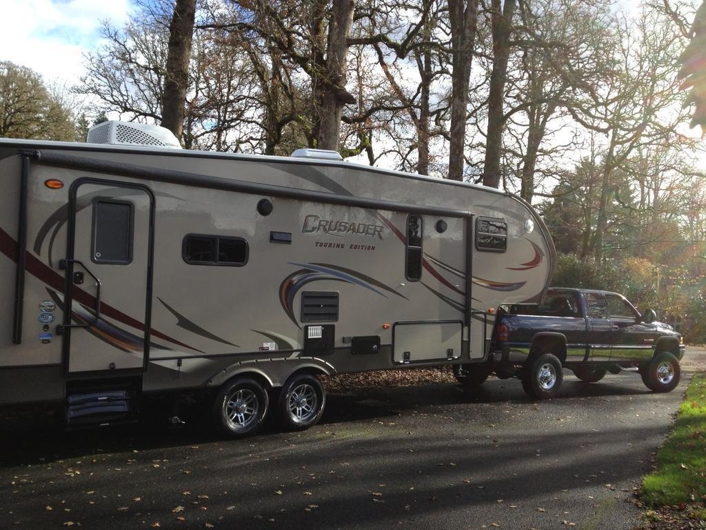

I have a Crusader 260. I don't have any photos with it hitched to the '14. I can tell you that when I got it, I had to have it lifted 4" to have a comfortable clearance with the '01. The springs were flipped at the factory. The bed height is the same on the '14, however it doesn't squat down as far. With the heights of these trucks, you may reconsider and have the trailer lifted.
The photo's not the best, but you can get the idea of the clearance. If you are getting off the pavement anywhere or going over RR tracks, going over any uneven areas, it will be a must to ensure you don't pinch the bed. Just my 2 cents worth.
