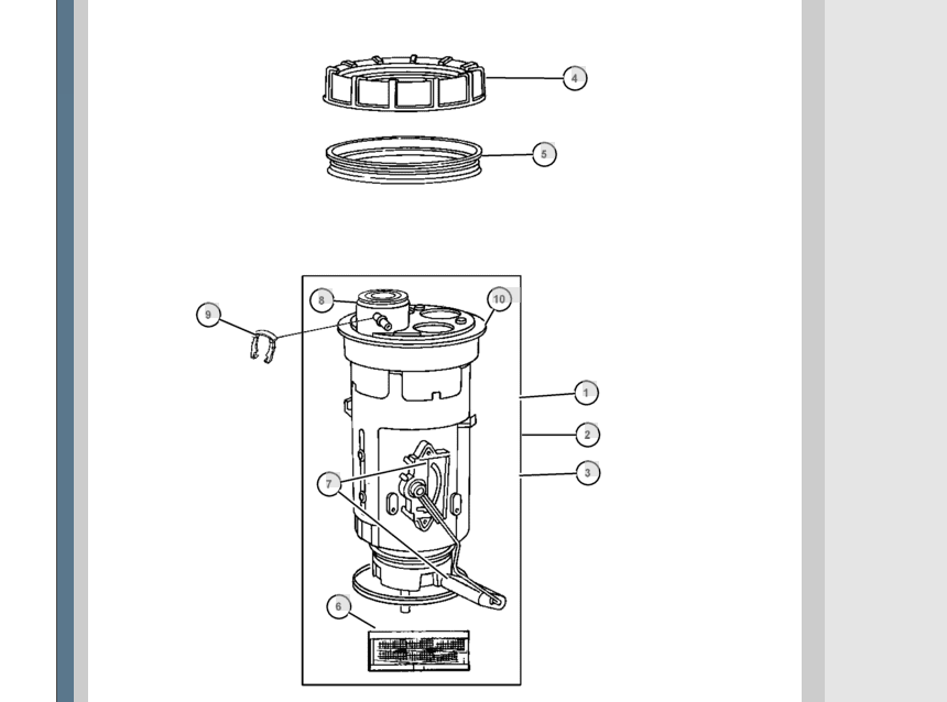

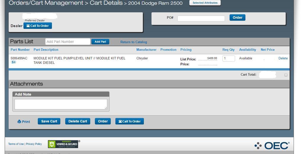

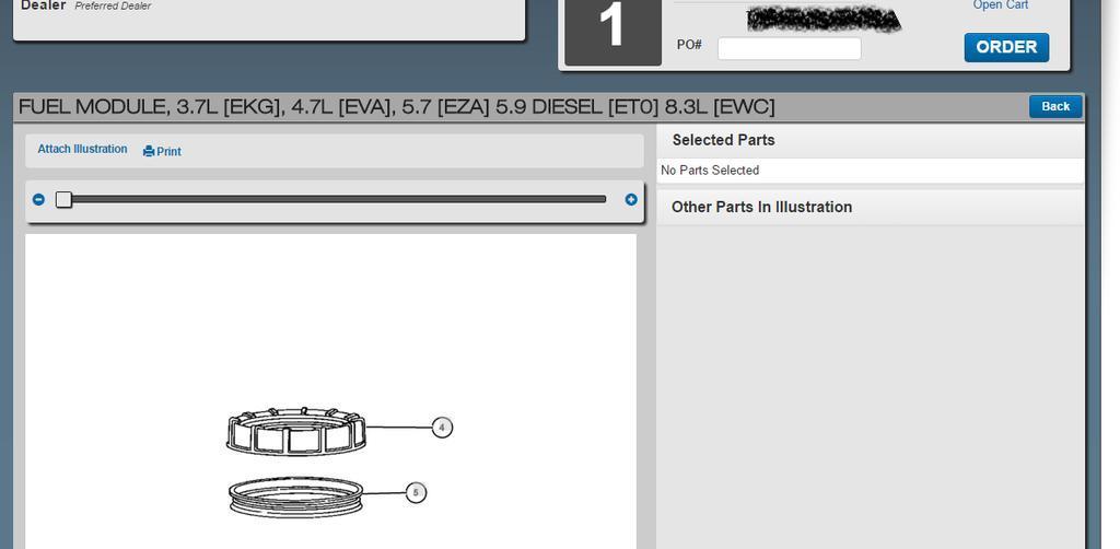

Ozzy, I thought I had your VIN but I can't find it right now. Doing a parts search by year and model on my OEC link that connects to my local dealer I come up with the following...
I missed this thread earlier or I would have got on it for you....
They have one in stock, I can have them send it over for a photo shoot if you want.
Get me the VIN so I can triple check this also.
That canister dont work in 04.5, i did check this with GDP as i mentioned earlier in this Thread.
