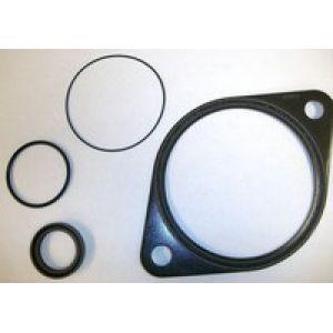

I am working on a 91 Cummins & I need a new seal & O ring for the vacuum pump bracket. Incase, the bracket attachs the power steering pump & vacuum pump.
I bought this "kit", Cummins P/N 4089742. It has all the seals and was about $15. I resealed the whole thing, it was a mess but thankful after I did it.

I have a kit for the power steering pump but I ruined the bracket seal thinking the seal in the bag was for the bracket & now I am kicking myself.
Is this kit a MOPAR or Cummins number? And you said it has the seal & O ring for the bracket that goes in between the two pumps?

I assume you mean the big seal, that goes from the vacuum pump to the ps pump? I found a picture of what's included in that part number. You can get it at Scheids, Pure Diesel, your local truck shop etc.
