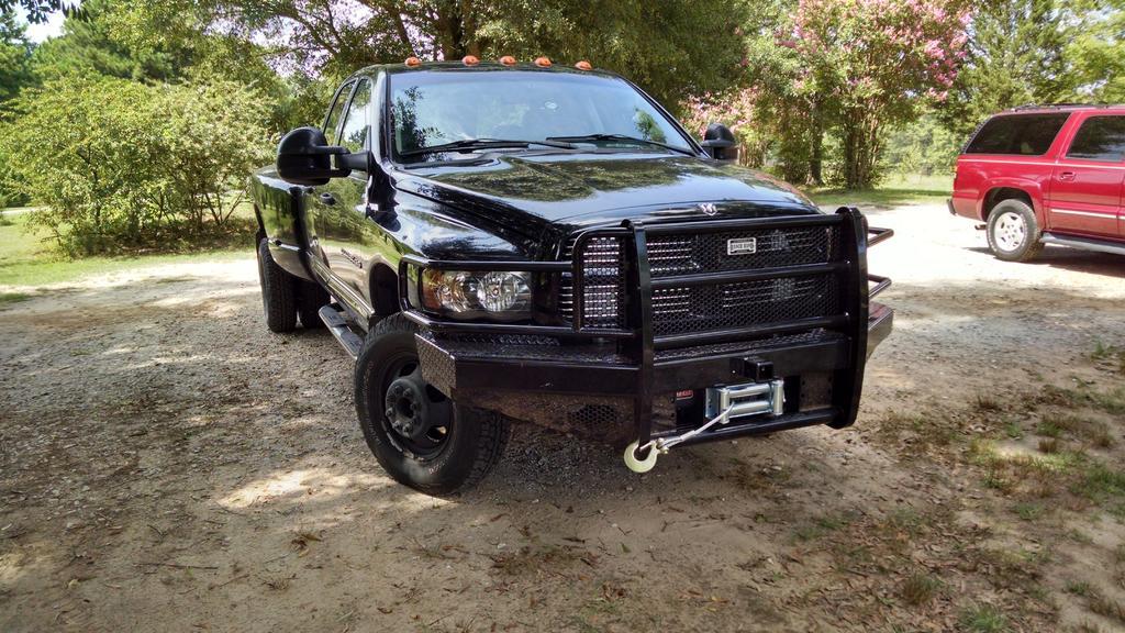

Looking to get some Alloy wheels for my 2004 Ram 3500, going black, any recommendations,
Thanks
Kyle
Check out Rims N Tires and Rimz One, Rims N Tires has a very cool rim and tire size calculator. I suggest you shop the price after you have made you selection. I'm in the process of new wheels and tires and have found as much as 25% difference in cost. Beautiful rig! What is the bumper?
