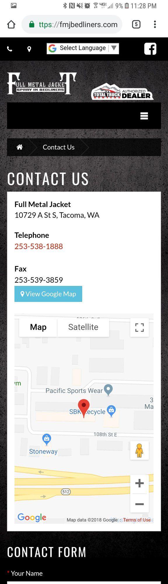

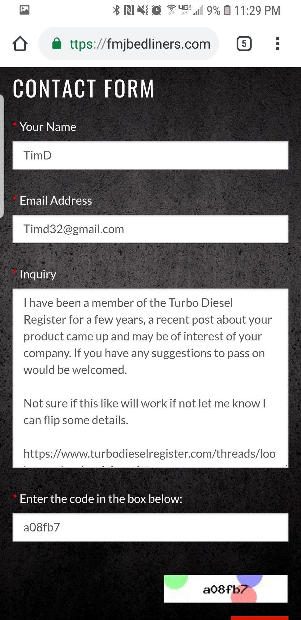

I found what seemed to be the Full Metal Jacket website? Submitted a Contact us of this post.
https://fmjbedliners.com/bedliners
If I hear anything will let you know, or you can contact them direct and see whats up, the product specs on the site, sure are not represented in your the photos.
