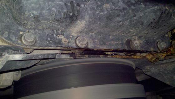

My buddy noted some dripping from under the front of my truck yesterday and I put it off to condensation from the A/C. Unfortunately, that isn't the case. I have fluid that I think is coolant coming from the between the front of the oil pan and the bottom pulley. It has blown all over everything from the track bar back. While parking and running it is a steady drip that slows as it sits after the engine is turned off. Am I looking at a waterpump or waterpump seal?

That would be my first suspicion. The drip slows down after shut down because the cooling system pressure drops.

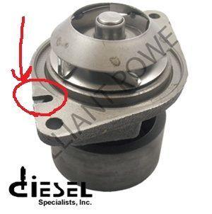

The weep hole may be this style so it runs right down the front of the block...

Those bad u-joints shook the water pump loose. :D
