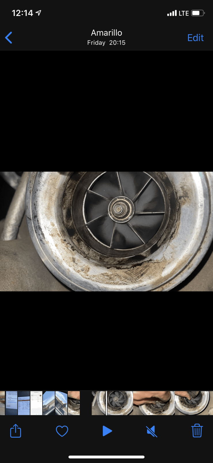

Sounds like your burning it all. Perhaps the turbo is leaking into the intake system. If so, you’re probably not all that far from a runaway situation. Inspect the front of your turbo and see if there’s any play in the shaft. Also check the intake for any oil.
I have video of me spinning the turbo and trying to wiggle it but don’t know how to upload it here lol! There is very little play on it.
