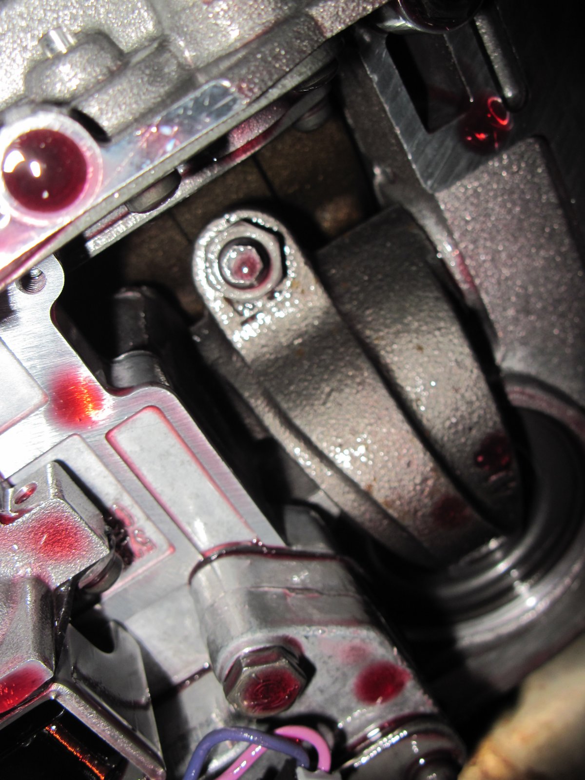

Are you able to drop the pan and have a look for anything obvious? I had the exact same symptoms on my 47re with less than a thousand miles on a fresh rebuild. The transmission shop neglected to tighten down whatever this actuator type do hickey is. A bit of vibration and a few bumps and this piece fell right off. Sorry I don't have a before shot. It was sitting on the bottom of the pan in a transmission shop far from home.

The culprit for no reverse turned out the be the shift lever that actuates the low/reverse band via the servo had bent. I have not seen pictures of it yet, but he kept the parts. He said he used the most heavy-duty parts he could find when he rebuilt it, and blames it on cheap Chinese parts.
He pulled the transmission apart and checked the clutches, which he said are ok. He drained the converter and filter, and replaced the oil with new. He wanted to keep the truck a couple days to drive and make sure it's ok. He drove it about 155 miles going to work and back two days, plus test driving through various situations. He returned it directly to my house last night after burning up almost 1/2 tank of fuel in testing.
He says he used the heaviest-duty part to replace the shift lever, and says it should be ok now. He also said the low oil issue he told me about before was not a cause of the problem. Personally I think most of that was a miscalculation.
