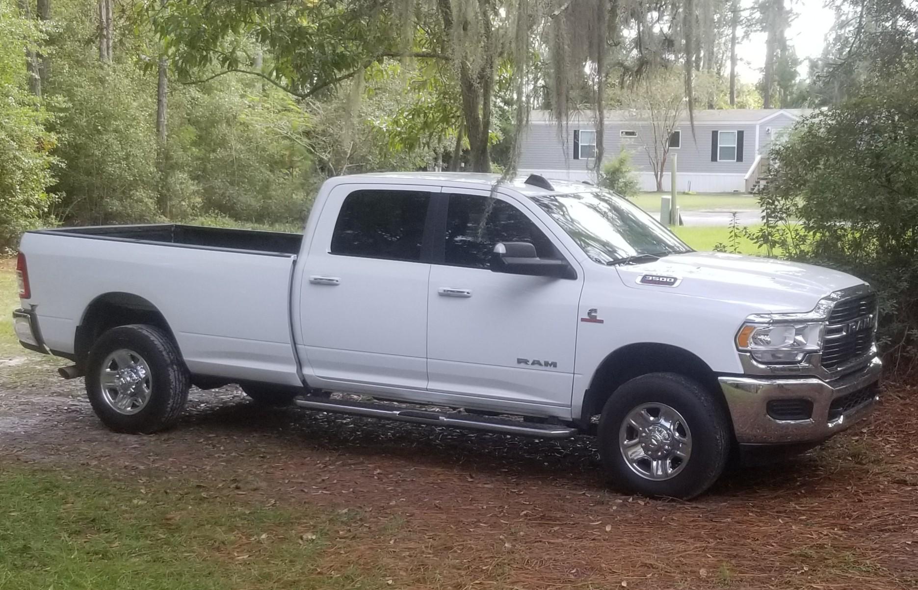

Gentlemen, Weird issue with my 98. About 3 weeks ago I went on a trip from southern Ga. to Ky. After getting out of S. Carolina backroads and back onto the highway I went to pass a vehicle and my truck wouldn't muster over 60mph. Boost is way low at times, and at most maybe 13. If I put pedal to the floor it seemed there was nothing left to give past a certain point. I've had no spare time until today to actually start checking for a boost leak. Another weird issue is I stopped for fuel 4 times, 2 times on way up and 2 times heading back. One of those times on way up after stopping for fuel and getting truck to pull out onto road the truck just died. This happened again once on way back also. The low boost/low power seems not terribly bad at times and other times seems really bad. In the last 3 years I've replaced the OF valve, lift pump and fuel lines. Where do your heads go on this one?? Meanwhile I've gotten me a replacement truck while the 98 rests in the form of a 2019 3500 Big Horn LB 4WD!
