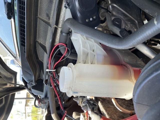

My low coolant light has been on for a few months and I decided to change the sensor out yesterday. The coolant level has never been low so i figured the sensor is the culprit. I took my inner fender out and changed the sensor. I was expecting a coolant bath but the sensor came out dry. Is that normal? I would assume that it is a wet sensor, but I pulled the old sensor and not one drop came out. I did have the reservoir cap loose to relieve any pressure. This has me really stumped, and my light is still on. Any insight is appreciated. Thanks

Initially when the light first came on the coolant level was right below the "max" line. I topped it off to level and the light stayed, i added just a little more and it would boil over when towing. There is coolant in there, i will verify again this afternoon. Would there be anything that would prevent coolant from getting to the sensor (i.e. baffles, or passages within the reservoir)?
Tank on my truck is very discolored, I shine a flashlight down through the cap opening to see the level of the coolant.
Fill line is basically right at the parting line between the top and bottom half of the tank.

there’s plenty of coolant in there. Just above the seam

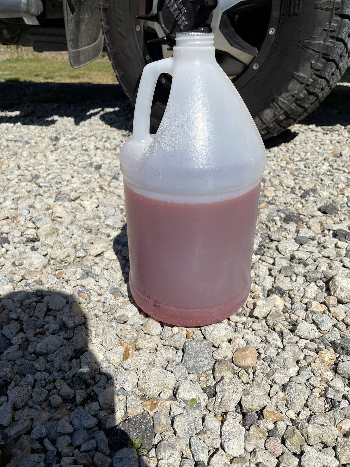

I could probably cut some zip ties to get it in coolant. But there was almost a gallon in the reservoir so why was the sensor dry and nothing spilled out?

I couldn’t when I emptied it out. I’ll have to try later on and get the inner fender back out and go from there. I wish I had a spare reservoir to look at and see what could be in that area that’s causing the sensor not to come into contact with coolant
Sediment and discoloring of the tank is most likely your problem, @tlevan03 .
