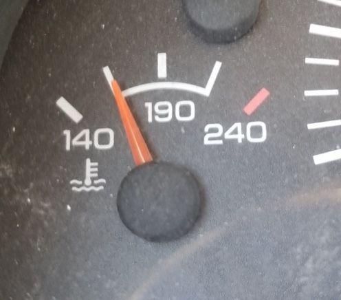

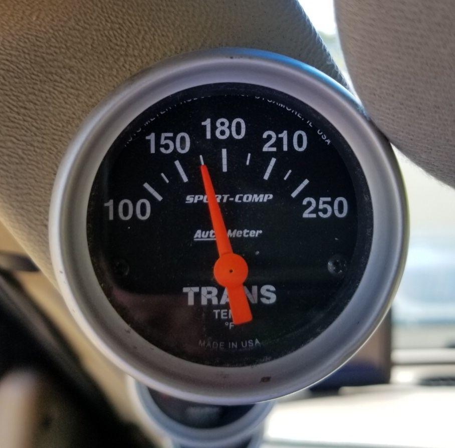

I'm having an unusual issue I just can’t figure out. My coolant temp will hardly ever get over @ 160*. I initially thought my 5 year old thermostat was stuck open so I replaced it Friday with a new Cummins 3928499, no change. I replaced the water pump with a new Cummins Water Pump in October. If it wasn’t pumping I’d think I would see high temps. Both radiator hoses get hot so I don’t think it’s a circulation issue. I lasered the thermostat housing after driving 40 miles and it showed 168*. I’d say I have a sensor or gauge issue but my transmission temps are low, too, and read the same as my ECTs.
Ambient temps in the lower 90’s, high humidity. City traffic and interstate driving empty. Fan clutch is functioning properly.
Tell me what you think.
