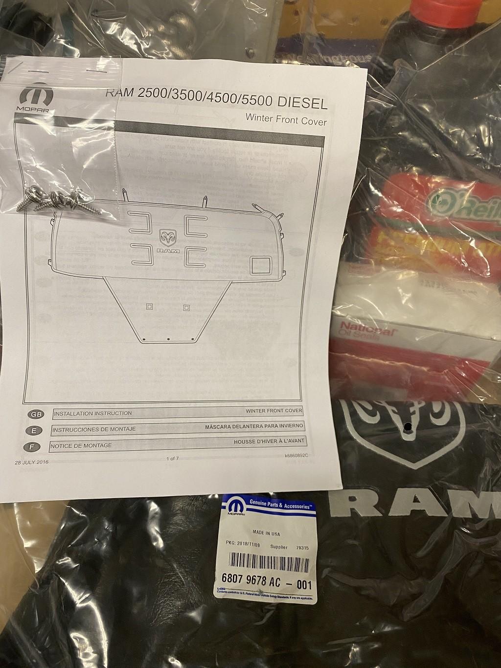

Agree. When I was in MD, I made an adjustable cover for the front of radiator... mad BIG difference.
Y'all try it out and let us know if it works.
Cheers, Ron
Thanks, but that cover is on. We live in Wisconsin and yes, that went on first. Makes no difference.
