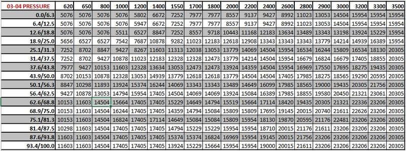

Here is the stock rail pressure table. Idle should be around 5,000. There are things that effect this, coolant, IAT, etc.. but that's close.

What he said. A good rail pressure on the 03-04 truck should be around 5k psi when warm to operating temp. If it is not, something is causing it to be high\low.

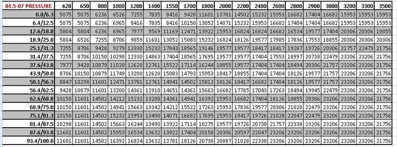

Where's the chart for the 04.5+ years, does their rp not run higher than the 03/04's throughout their rpm's? That was kinda my point, but I missed the mark...my gauge usually reads 7k idle at start up, when warm it reads 4+ to 5k, is that more suitable for you two forum policeman :D ???

Here you go. Oo_Oo.

How do I read the charts, I believe the top row to be RPM, the left side..TPS?, requested/commanded pressure? Sure seems to be a heck of a difference in ramp up pressure between the two, can I assume this was to meet emissions with the later CR's?

Left is approximate engine load.
I run in between the two. There are places I run more than both, but generally I am lower than 04.5-07 and higher than 03-04.

The ECM is trying to meet a certain fueling demand, or load. 100% load is 140mm3 of fuel per main injection event. Once the ECM determines how much fuel it needs, based on throttle position, rpms, boost, etc it looks to the rail pressure table for desired pressure. So if you where WOT at 2000 rpms, on you 03 with stock tuning) it would want 15954 psi. 50% throttle would be approx 70mm3 or 50% load.
Clear as mud? That's the cliffs notes, there are other factors but the concept is the same.
