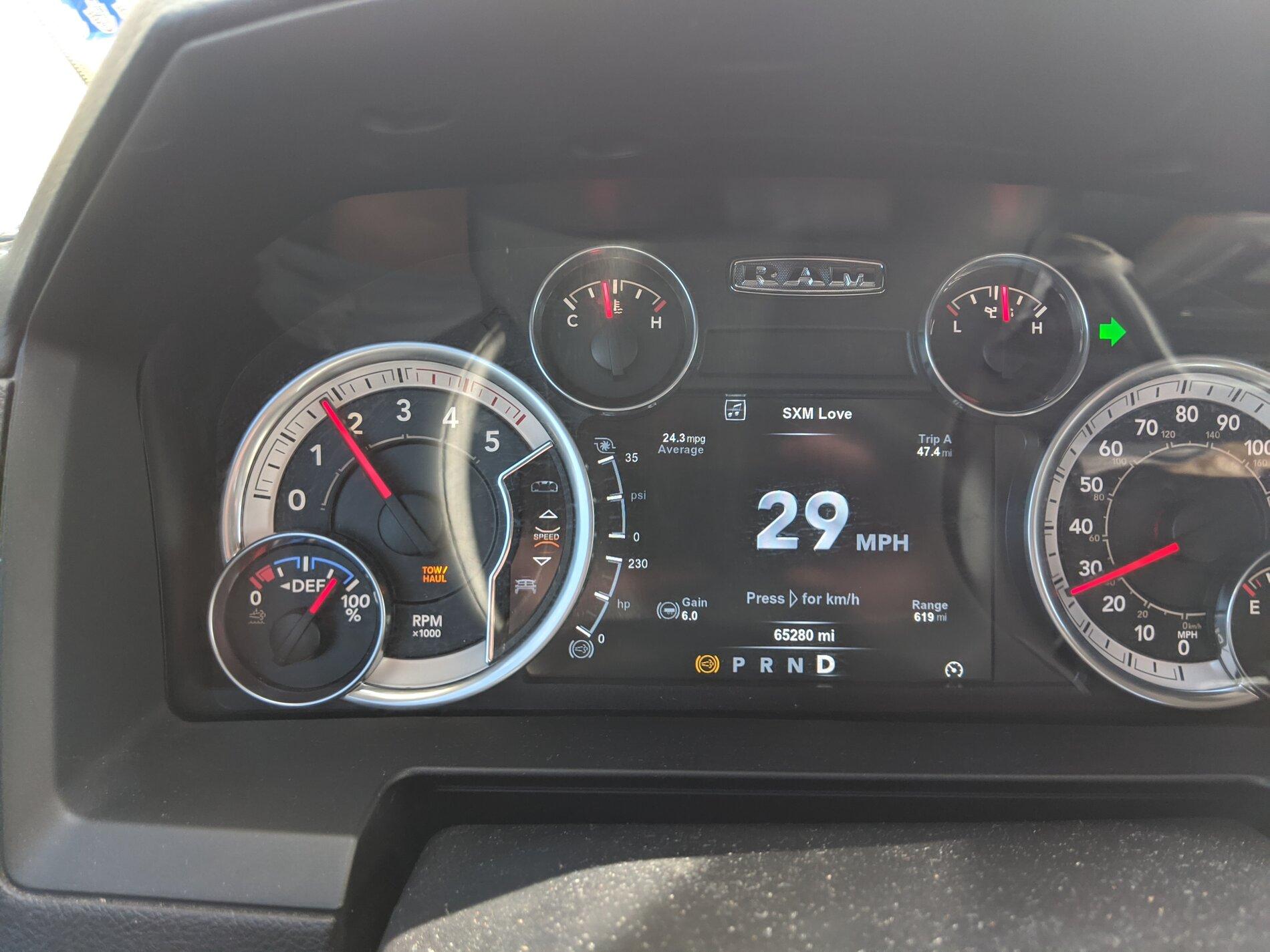

Low speed loaded test of 3.42....

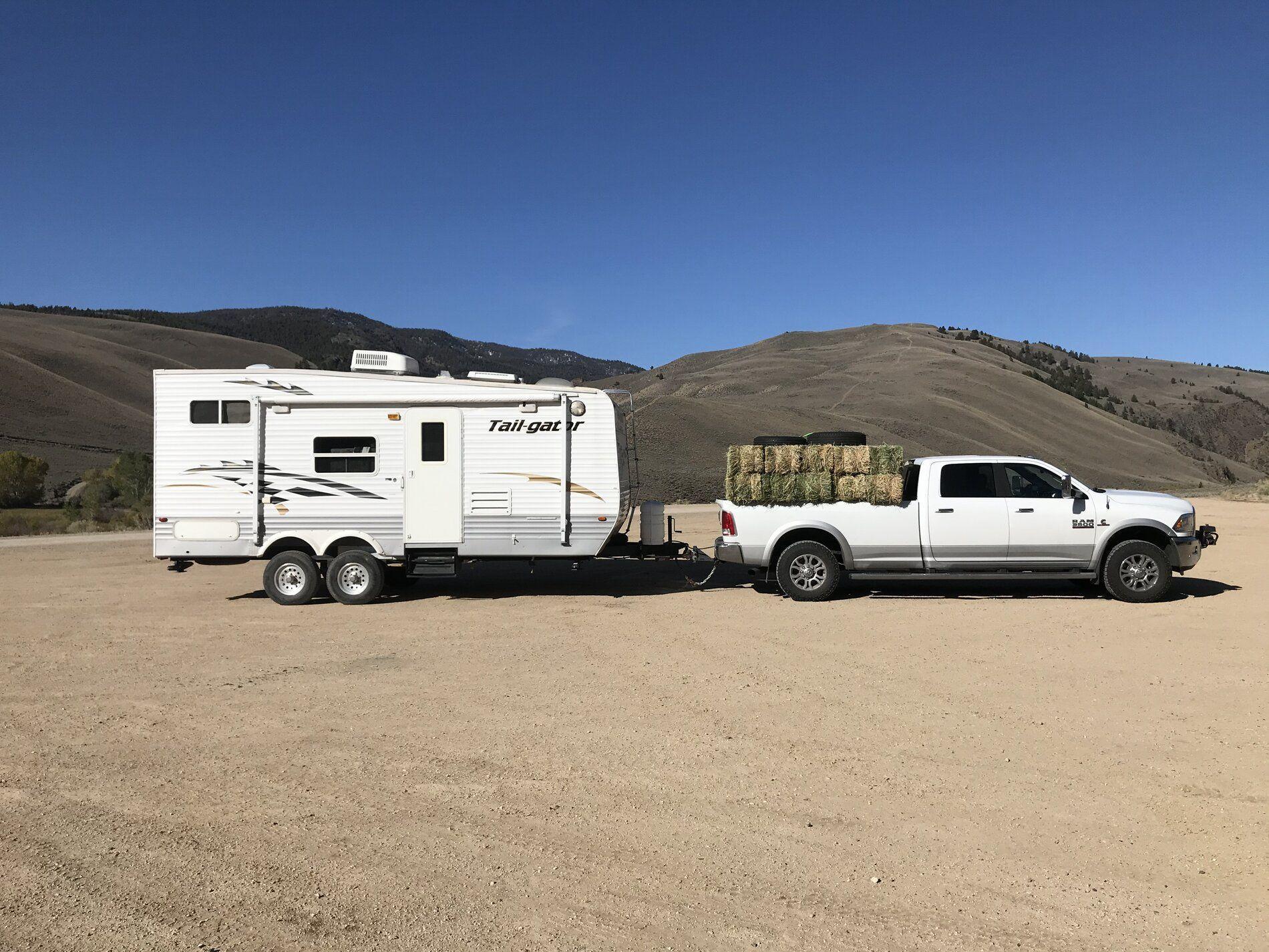

I didn't buy the truck for mileage that's for sure. I bought it to do a specific job and it does so extremely well towing up to 35k combined when double towing.
