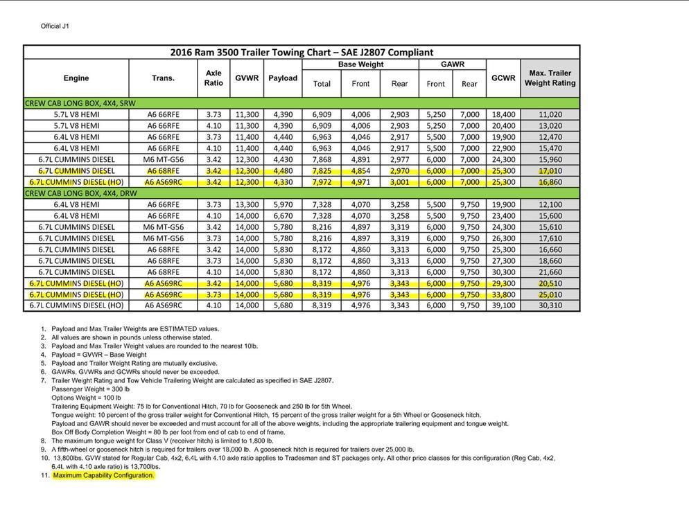

The tow charts for the 2016 3500 crew cab long bed 4x4 Rams seem confusing,
With the Single Rear Wheel (SRW) The heavy HO engine with the heavy duty Aisin transmission actually loses a little tow capacity over the 68RFE, if that's the case why spend the extra money for it?
And if you compare two identical HO trucks w/ the 3.42 rear , with the only difference being the Aisin and SRW vs DRW, the DRW truck has 4K more trailer towing capacity.
My 12 year old old 3500 SRW has a 15,500 tow capacity, you'd think a comparable new 3500 would have gone up more than 2000 Lbs towing capacity.
Are these charts correct?
The capacity on that HO 3500 w/ Aisin seems underrated...........
I realize the Aisin weighs a bit more, but what's the incentive to pay for the HO diesel option and the Aisin heavy duty transmission, when it actually costs you towing capacity?
Also, why are the SRW's restricted to the 3.42 gear ratio?
A family member is looking to purchase a new truck, this chart has all but talked him out of the HO/Aisin option as there doesn't seem to be any sense in spending the extra money.

Guys, dont get lost in the minutia, it might have a better spread between a couple gears, but why does the option cost so much AND drop the tow rating? The HO/Aisin option should increase the tow rating not decrease it, You know, because of the better spread between the gears and all.
The SRW tow rating should be the same as the DRW, which would be 20,500 not 16,860.

Because you have to also be able to handle the pin weight. This ratings indicate that someone at RAM has become educated on what it takes to tow a large trailer including hauling the pin weight down the road. Even the fact that they give the Long Box trucks higher GVWR ratings than the Short Box trucks indicates that they are also looking at stability issues based on wheel base. SNOKING

A SRW truck is limited by the rear axle capacity of two tires, about 7K pounds. Can't get much of a gooseneck or 5th wheel and stay within its capacity. Hence the 3.43 ratio can support all the trucks supposed to pull. CAN it pull more? Sure. Should it? Probably not. Heavier trucks always can tow less as you take the GCWR -truck weight to get the tow rating.

There's 2,750 lbs difference in Rear GAWR between the 3500 SRW LWB and any 3500 DRW truck...................
4 rear tires have a higher load capacity than two rear tires.....
The payload drops by 150 pounds between the 68RFE and the heavier Aisin, which coincides with the difference in the published curb weight. Thats simply reflecting the heavier weight of the Aisin. The higher the curb weight, the lower the payload ratings.
Payload and tow ratings are established based on the trucks configuration, IE cab, wheel base, and SRW/DRW. Not just engine/Trans options.
