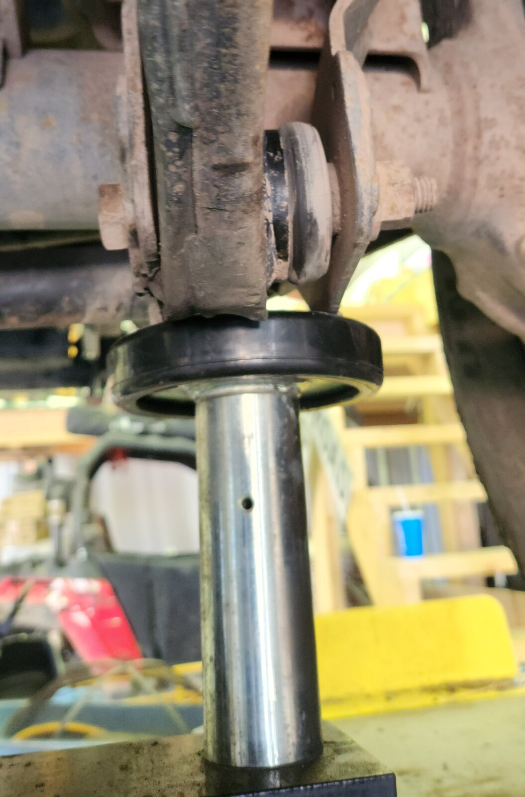

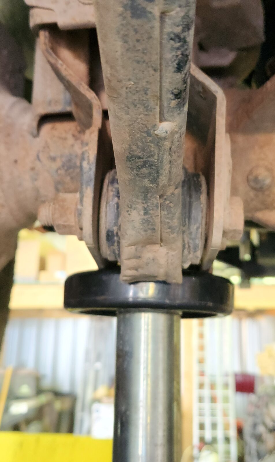

While I had the truck on the lift looking for a rattle I found something odd. Curious as to why the passenger side lower control arm looks this way. One picture is the drivers side, other is passenger.
Looks like the part of the control arm bushing is damaged/missing in the lower pic.
NOT sure if you can get replacement oem bushings, but if not, maybe simply consider getting aftermarket lower control arms rather then paying for OEM.
Replace the arms. Mine almost fell apart from rust on the end. They aren't really expensive.
Count on getting all new hardware as the bolts typically need to be sawzawled out

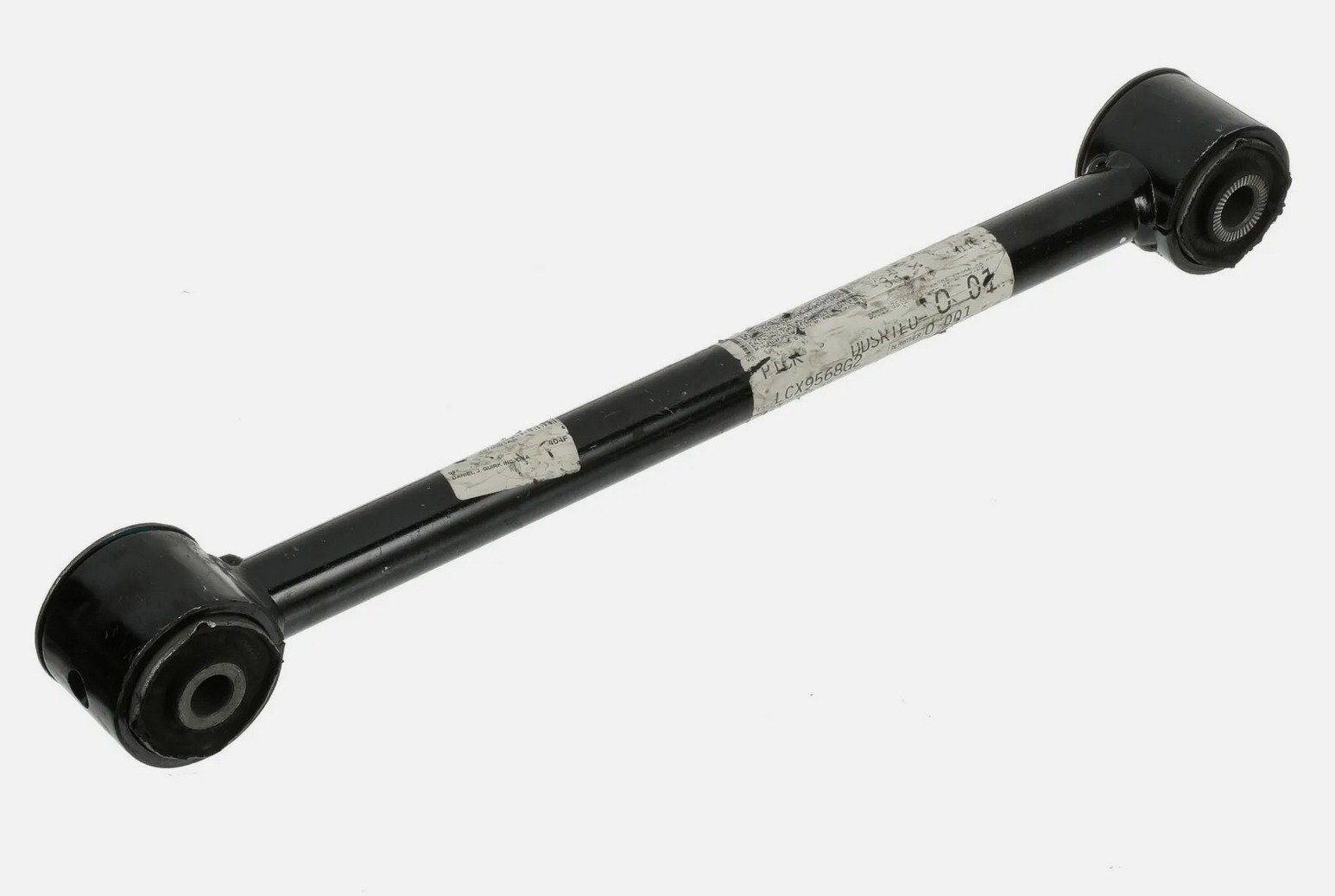

Carli control arms are my recommendation. Have had them on my truck for about 40k no problems. Greaseable and rebuildable. Buy once, cry once.
You already know the OEM ones are junk.
They aren't available anymore for a decade.
Ram went away with that design before I bought my truck and I replaced the factory with the new style ten years ago and they are still in perfect shape. Nothing beats that quality.
120k on the clock and counting, no greasing, no rebuild, nothing just works.
And many of these miles are on bad gravel roads, these arms get their share of beaten up many times.

Are these upgraded arms 1/2" longer or the same?
I have the sheetmetal arms, they are not tubular like the above picture. If I can find the bushings are the sheetmetal worth holding onto? I can get a full set of new tubular arms like above for around $200.

Most of these types of arms use real cheap bushings that you cant get replacements for, I have thrown out many sets of cheap aftermarket arms because the bushings were shot and couldn't find replacements. You get good quality or cheap, cant really get both.
Not worth to change bushings, I did in the past on my JEEP with the same style arms and it was difficult to get the new bushings to hold in the stamped sheet metal arms.
In the end I spot welded them in. Crap job.
Replace and forget about them for the next 15 Years to come. Small price per mile for decent stuff.
