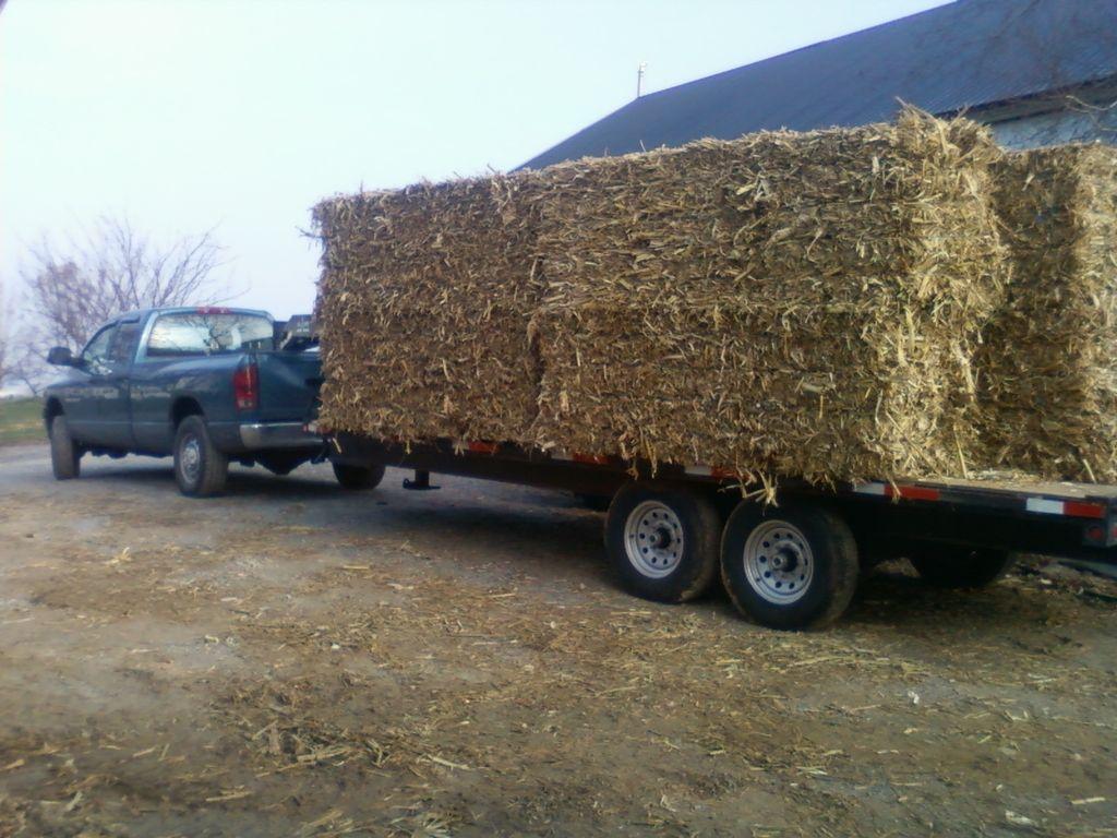

Well, i did some towing and i think i will leave my spacers where they are. With a gcvw of 22500 my Ram was slightly under level at the rear. Thanks for the replys!! If i didnt haul/tow, i would consider this though.
Corn stalks, or corn fodder as we call it. We shred the stalks with a flail chopper, works well for animal bedding. They pack solid with a big square baler. 850# each, a load of 14 weigh about 12,000# which brings my gcvw to 23500.
