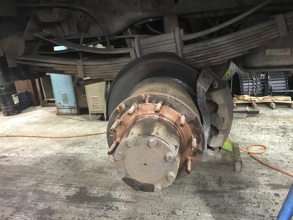

This is not an exaggeration. If you don't do this on this truck here in the rust belt, you'll need heat.
