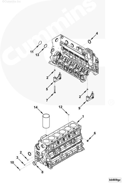

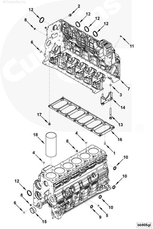

Ok, sounds like you are on it. The phrase "Correct Main Bearing Caps" makes me less worried.
The loose parts and stuff are from a lower horsepower industrial "B" series I believe. Some people think "They're all the same".......
I looked up my "06 and immediately noticed the block stiffener plate and that all seven caps are the same part number, then the light went on.......
With the proper caps and a line bore you should be in a little better shape.
